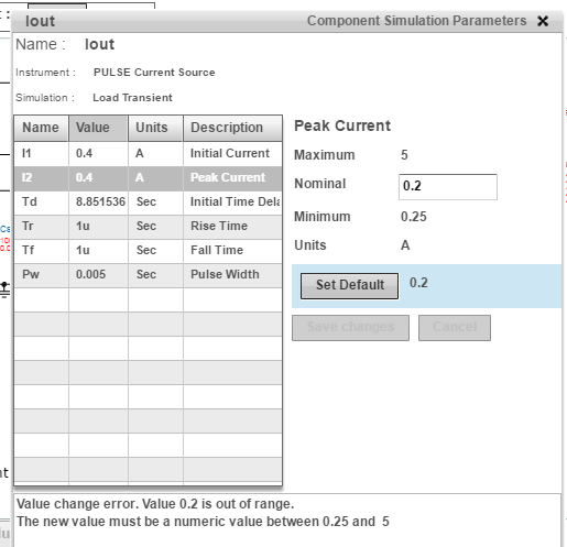

  In load transient of TPS55340, I need to simulate transient load which changes from 0.2A  to 0.4A and back to 0.2A but the minimum value allowed by pulse current source is 0.25A.
Request you to change minimum value to 0.2A.
Set Default value is given as 0.2A but it is not working.
Thanks and Regards

     TPS55340 is supposed to operate for all currents less than 5A.
     But there is a minimum threshold of 0.25A in load transient.
    Load transient case is shown in the first post and request you to change the minimum level to 0.2A.

  • Hi Vignesh,
    The constraints that is been put is conventional. So please trying using the sim export option where the design can be taken locally and modified as per the need.
    Please let me know in case of any queries.
    Raghav
