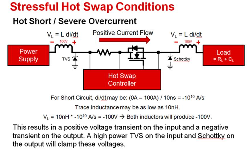

The simulation models for lm5069 hotswap controller which is given in the texas instruments website contain
1.TVS diode at input
2.output capacitor
can i know the part number and values of those 2.
Like when i simulated Lm5069-2 which is designed for 50V was giving 24 V at the output..when i used CSD19536ktt as NMOS..what may be the problems?plz suggeset

  • Hi Akshay,
    I would recommend to also add a Schottky diode at the output.  We recommend all designs with a hot swap controller to have a TVS diode on the input and a schottky diode at the output (for short circuits and overcurrent shutdown). All wires have trace inductance and in the event of a hot short (short circuit) or severe overcurrent (fault timer), those wires could produce a huge change in voltage at the input and output. I recommend the B380-13-F schottky diode, and make sure the TVS diode clamps the voltage lower than the abs max of the device at the worst case clamping current.
    The value of the output cap is dependent on your application. Maybe a 150uF cap should be suffice.
