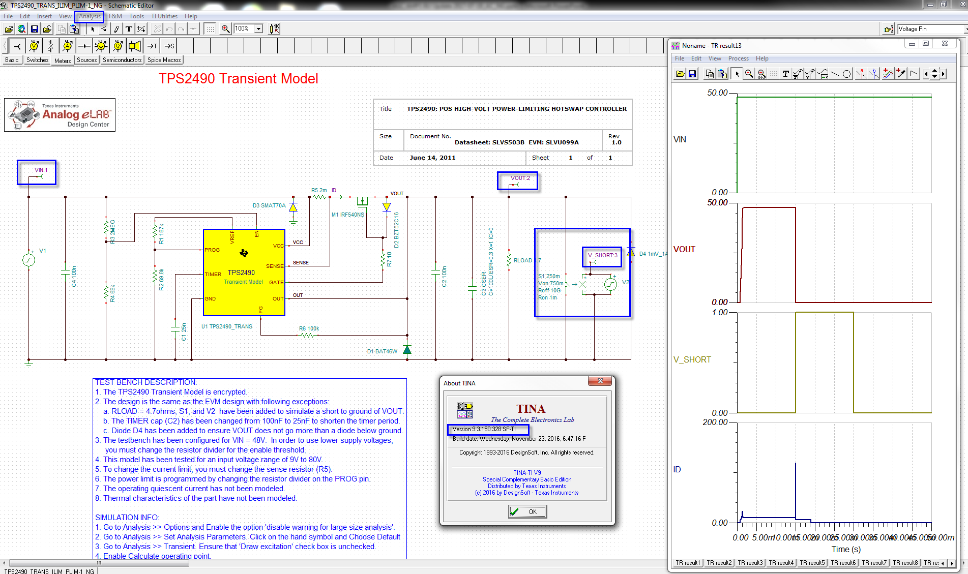

I have loaded the example simulation for the TPS2490 and have set the simulation parameters as instructed on the notes on the schematic. I have not changed any thing in the design. According to the notes on the schematic it should only take about 1 minute to run the simulation.. when I run the simulation I get a progress bar but it never moves off of zero even after 20 minutes of running. I have run the updates and am using version 9.3.150.4. Any suggestions why this does not complete?

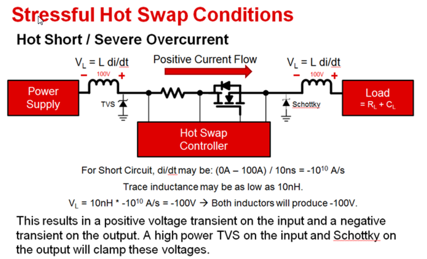

    On another note, we recommend all designs with hot swap controller to have a TVS diode on the input of H.S. and a Schottky diode at the output of H.S. for transients. All wires have trace inductance and in the event of a hot short or severe overcurrent, those wires could produce a huge change in voltage at the input and output. I recommend the B380-13-F Schottky diode, and make sure the TVS diode clamps the voltage lower than the abs max of the device at the worst case clamping current.

  • Thank you for pointing out the resources for hotswap design. I have already used the spread sheet design and would now like to simulate the design to verify it. I have found one problem with the example that is provided by TI for this part. The input voltage is set to zero. Also the voltage that controls the load switch is also zero. I have set the input to 48V but am not sure what voltage to set the switch control voltage to. I am a new user to TINA and I do not understand what signal is being plotted since I do not see any probe points on the schematic. Could you help with my simulation issues or do I need to contact some one else?

  • TPS2490_TRANS_ILIM_PLIM.tsc
    Here is the file that I am trying to get to run. It is located on the TINA install at C:\Program Files (x86)\DesignSoft\Tina 9 - TI\EXAMPLES\HotSwap\TPS2490.
    I am not referring to pin on the part I am referring to V2 on the simulation that controls a switch that simulates what happens when a short occurs. If you could make changes to this file and send it back so that I can load and run it that would be very helpful. It will never complete when run as the notes on the file state to set up the simulation.
    I now have learned by much trial and error that the voltage sources are piecewise sources that change V with time and the vin is suppose to go to 48V after 10uS. I did get this to run with a DC transfer but what I really want to see is the dynamic behavior.

  • Hi John,
    The file ran fine for me as is on the latest TINA-TI version on the web (9.3.150.328). Can you please upgrade to this version and see if your issues still persist?
  • As I stated in my original post I am running 9.3.150.4 which appears to be a higher revision than yours
  • John,
    I believe your version is 9.3.150.004. The latest version is 9.3.150.328 from Feb 2017. Have you update TINA-TI after Feb 2017?
  • I just ran the update and it comes back that I am up to date with no new components available. The HELP/ABOUT menu shows 9.3.150.4
  • John,
    In order to get the latest version of the tool, you will need to re-download and install the new version of TINA-TI from the web (not update it from within the old version).

  • I down graded to the exact version that you are using and after waiting several minutes the progress bar still shows zero percent
  • I have reinstalled TINA with no updates and am now at the same version as you and the simulation still never completes after waiting several minutes.
  • Hi JOhn,
    I am not able to reproduce the simulation getting stuck in this version. It ran fine for me. However for what you want, I made some adjustments.
    1. Connected the Switch simulating the short in parallel with the 4.7ohm load.
    2. Adjusted the R5 resistor for the large current in drawn due to 48V input and 4.7ohm load
    3. The Switch controlling the short has thresholds set to 250mV for OFF and 750 mV for ON. Hence I used 0 and 1V as the levels for the V2 switch.
    You can get the desired results as is, but since the time step is not controlled, you may see some wierd transition for S2. Hence, I also adjusted the time step to 1us (from Analysis >> Set Analysis Parameters).
    Modified file and results are attached.
