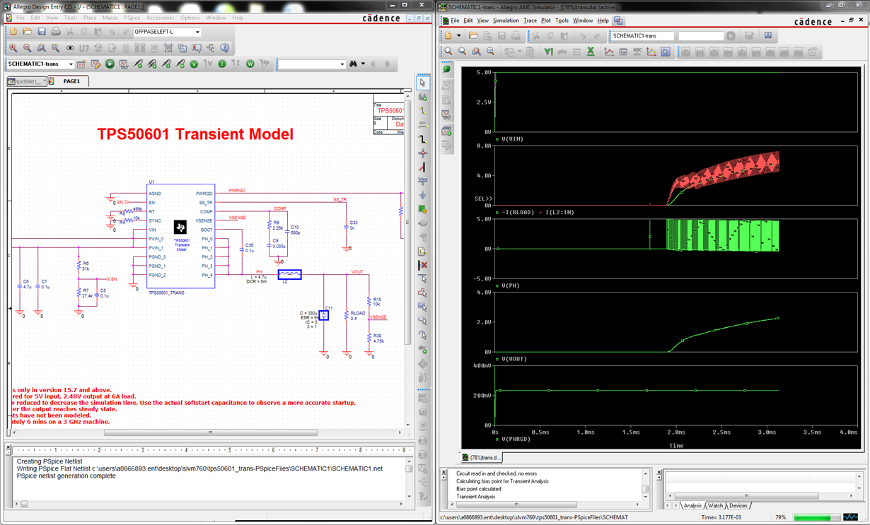

It appears that when you download the PSPICE model of the TPS50601, the "out-of-the-box" test bench example of the model does not allow you to run the model. It is locked or something and thus read only. I cannot run the model or make any changes to the circuit and save.
For the transient model at least, I could include that library and recreate the test bench in-order to try out the model. Can you look into this for your pspice models?

    I confirmed the PSpice Transient Model and it ran without any issues for me in PSpice 16.2. Not sure what the exact issue is that you are facing.
    On SIMPLIS v/s PSpice, for Bode plots, the switching circuit needs to be linearized first before the AC analysis can be run on it. Since SIMPLIS is a piece wise linear simulator, you can run Bode plots on the switching model directly. The same is not  true for spice based simulations. Hence an average model needs to be created which can also be found in this devices product folder:
