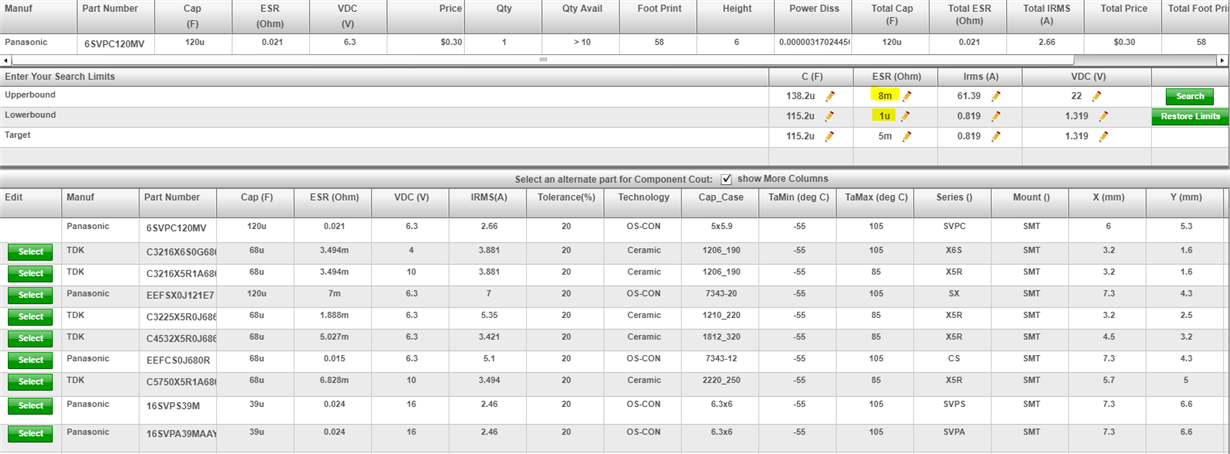

However, the output capacitor can not be changed to a ceramic capacitor.
Why is this?
I would like to install 100uF ceramic capacitor in parallel.
I want to know the background of the constraints stated in the red.

  • I can change it manually as a custom component, but of course I get a warning about ESR being too low. There is not an option to add mixed capacitors for this device, so you have to pick one or the other type of capacitor. I think you best bet is to use the pspice transient model and check the load step response for stability, or better yet, modify and test and EVM.

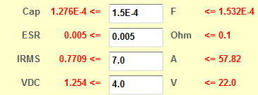

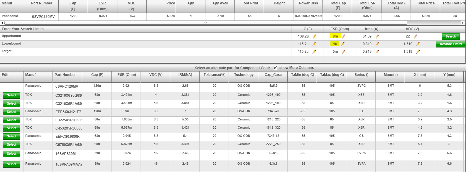

  • The WEBENCH design is recommending only non-ceramic caps due to a constraint in the minimum esr on the output cap. The esr constraint on the output cap comes from the ripple injection requirement needed by the TPS543C20. One thing that can be done to be able to select ceramic caps is, to go to the select alternate parts page and relax the min and max esr limits for the output cap as shown below highlighted in yellow. Originally those values were 0.1 Ohm for upper bound and 5mOhm for the lower bound respectively.
    By updating the values to 8m and 1u, we start seeing ceramic caps in the list. As John mentioned before, the best is to select a ceramic cap with esr close to 5mOhms and verify with pspice that we are not violating the minimum esr requirement.
