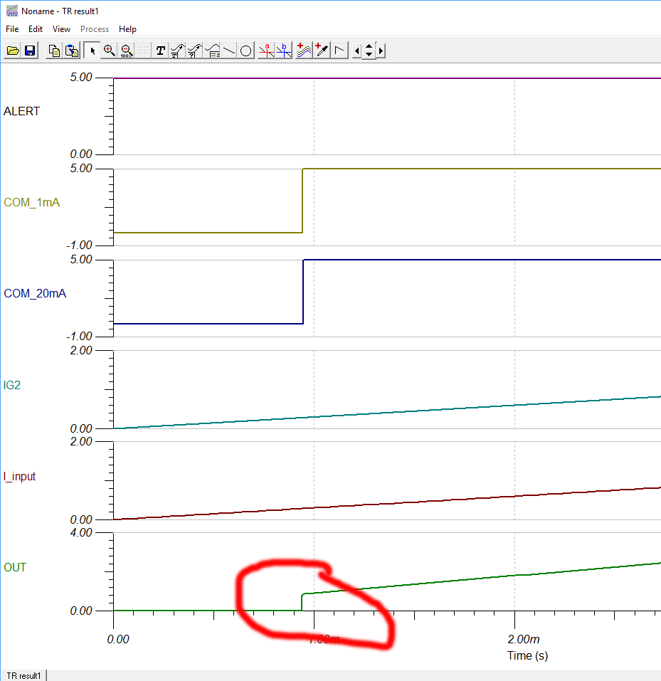

Hello all, help to choose Current Sense Amplifiers for the range 1мА - 1А.
Rsene is not larger than 1R. Better than less than 1R.

Andrew,
The internal op amp's voltage-limiting circuitry is having trouble recovering from output saturation at either rail.
It eventually recovers, but the time delay leads to the output glitch.
I am not sure how long this will take to fix, but I will give an update next Wednesday, 8/23.
The same block is used in some other models, so the fix we come up with here will propagate to those models as well.
Thanks for taking the time to point out this issue.
John

Andrew,
I think we might have a solution to the problem you have experienced with the INA301A1 model.
Please look at the attached circuit and let me know whether or not the revised model is okay.
Thank you for finding this and taking the time to point it out.
