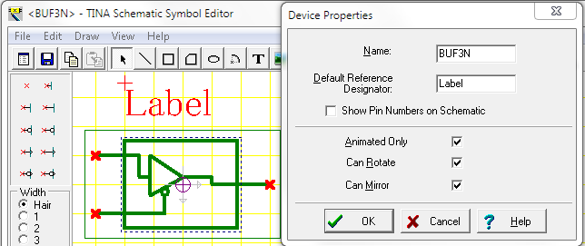

Since TI did not implement logical elements, but provide some dummies with TINA demonstration projects, I just copied a symbol from AND dummy for.. lets say a 3state buffer dummy; it does not matter.
I edited the macro, edited the symbol, renaming everything to "BUF3N".

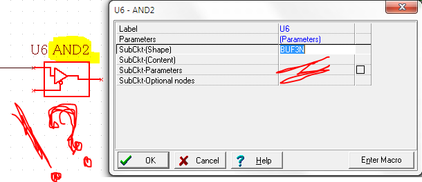

But in the schematics the symbol name stays "AND2" as before the edit.
And I can not create a new symbol, because there is another bug, damaging the pin "invisible connection point's" coordinates, when the pin is touched, or a new pin is created.

    What you modified was not the name of the component. It is actually the name of the drawing (shape). To change the name of the component, please select U6, and menu "Tools" > "Edit Macro Properties". You will see a form in which the field next to "Shape" contains the new (shape) name "BUF3N", above that you'll see the "Name" still says "AND2". Please update that field and OK the form, then deselect U6. Now you should see the new part name on the schematic. If you export this macro and insert it into another schematic, you will see the new component name.
