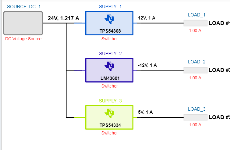

  • Hi Jovan,
      Here is an alternative solution proposed by Ed which avoids the transformer.
    Here is the shareable WEBENCH link for each of the designs.
    TPS43601
    https://webench.ti.com/appinfo/webench/scripts/SDP.cgi?ID=5BB34AC5F3E5BF12
    TPS54308
    webench.ti.com/.../SDP.cgi
    TPS54334
    Gerold

  • Jovan,
    I got some feedback after talking to an expert. Relaying the message here and hopefully this helps.
    You can lay the three designs just like the tree above with single input (note the 1.217A input current requirement to drive the three converters )and use a common ground. You will need to keep the switch node of the converters away from the critical path analog components in other converters. Also, please follow the guidelines for PCB layout from the respective devices' datasheets. Usually, there is a good layout guidelines section like on page 24 of the TPS54334 datasheet: www.ti.com/.../tps54334.pdf
    When you find alternative parts, try to find parts with same values and parasitics. You can always use the "Select Alternate Part" button from the BOM page when you click on the converters design within the WEBENCH power designer tool. If the alternate part is not available, you can choose something similar or create custom part. The tool recalculates the operating values and charts once the components are updated.

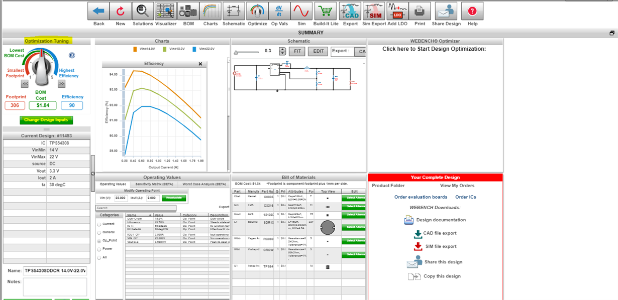

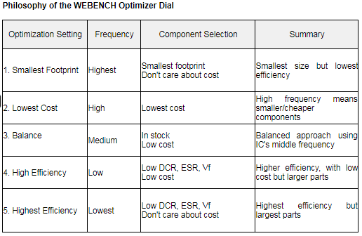

  • Hi Jovan,
         Optimizer Dial or Options can be found on the left top when the design is opened. Please find the Images below.
    Optimizer Dial :
    Optimizer Tuning Philosophy :
    Please go through the link below for more details about creating design in WEBENCH.
    https://webench.ti.com/help/#t=PowerDesigner%2FOptimizer_Knob.htm
