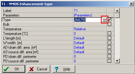

I am trying to create a simple level shifter circuit that has a pulse signal as shown in green on the TR analysis which corresponds to VG1. VG1 pulse alternates between high and low every 50ns. However, a proper level shifter matches the highs and lows on both the 5v and 1.5V. However, VF1 (red signal) shows a decaying signal. The ideal red signal is a pulse with a high of 1.5V and a low of )v alternating every 50 ns. Can anyone help to see what I'm doing wrong?

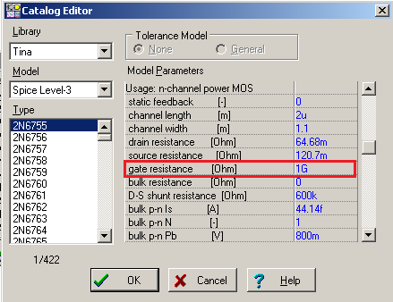

    Increasing the GATE resistance of the MOSFET resolves the issue. Below is the simulation result.
    To change the value of MOSFET GATE resistance follow the below steps.
    1. Double click on the MOSFET symbol. A window will open.
    2. Click on the button as shown below
    A window will open.
    3. Change the GATE resistance value to 1G as shown below
