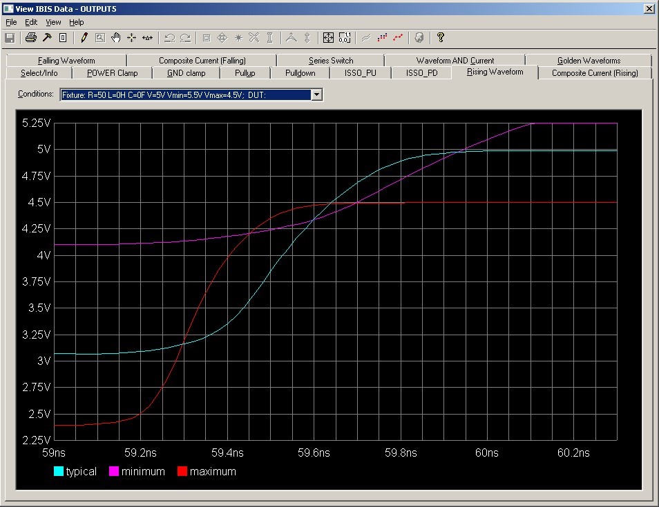

  • I am trying to do some simulation using the 7241C using the models on this forum but the simulation does not run properly, the signal is always stuck low or stuck high.
    Any help would be appreciated.
    I am using Hyperlinx 9.3
  • Lenny,
    The OUTPUT is a 3-state. When instantiated in Hyperlynx, the default setting is Hi-Z. You need to change that to Output or Output Inverted.
    Don't ask me why the default in Hyperlynx is high-Z. Just the way they do things.
    David
    Webench Design Center
  • I did that but I am still having issue, I had mentor look at the ibis file and they found a lot of errors, here is what I got out of them:
    The two falling edges and the two rising edges have to be moved by
    the same amount.  Note that the first time of these are around 59 ns
    and 107 ns.  These tables should start at 0.
    But I suspect some other serious problems with the waveforms.  Note
    that the V_fixture values are most likely in the wrong order:
    V_fixture = 5.0
    V_fixture_min = 5.5
    V_fixture_max = 4.5
    The min value should be 4.5 and the max value should be 5.5.  I
    suspect the same problem with [Voltage Range]:
    [Voltage range]         5.0V            5.5V            4.5V
    And also with the [Temperature] keyword, unless this is a bi-polar
    (not CMOS) device:
    [Temperature Range]     25.0            -40             125
    The reason I noticed this is because I see an obvious clipping
    effect in the waveforms for the min case at 5.25 V:
    If V_fixture_min=5.5, the waveform would usually go to 5.5 V, but
    here it is clearly clipped to 5.25 V…
