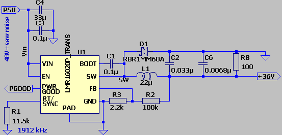

I am trying to simulate LMR16020 for +36V output with free and generally PSPICE compatible LTSPICE.
But using unencrypted model simulation fails with no POWER-GOOD signal and no good voltage at SW. I checked and double-checked all the pin numbers... and still.
Tried to see what WEBENCH thinks about it, and it knows nothing about LMR16020. Why?
Is it some king of orphaned and abandoned IC? In whitepaper it looks very pretty, simple to solder package, high power, integrated 2MHz clock and nMOSFET, relaxed inductor requirements(!)...
And still, I can not check the design in software.
Does the circuit look good?

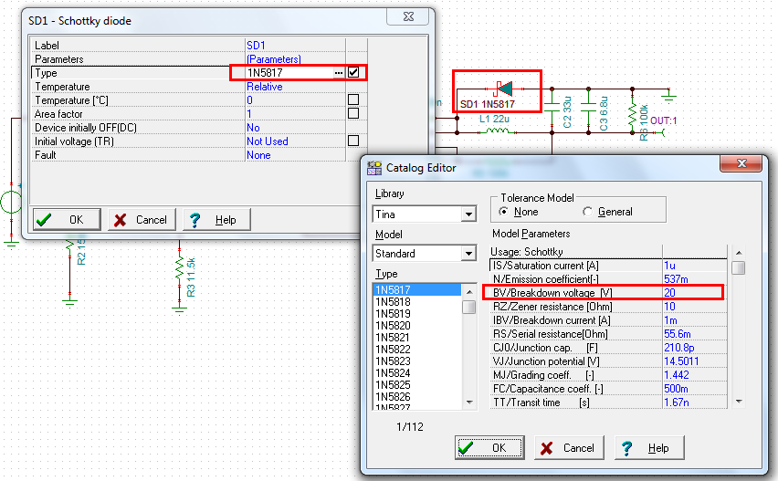

  • Hi Andrey,
    The model works fine with the following changes in the test setup.
    1. The reverse breakdown(BV) voltage of Diode used is lesser(20V). Recommended operating condition is to keeping higher than VIN and then it works fine.
    Currently I have made it to 50V.
    2. Also while keeping SS=1, please make sure to add proper initial conditions on Cout capacitors and Inductor.
    Also I have updated analysis parameters to support simulation. PFA the updated working schematic with above mentioned changes.
    test_36V_updated.TSC
    Please let me know if you have any other questions.
  • Thats weird
    I had RBR1MM60A in LTspice, and in Tina I took the first thing in sight, just in order to see anything at the output. And I do not see anything even when putting BAS70 there.
    SS=0 at my side.
    But your file simulates well.
    What did you do else, to make it run?
  • Ah, I see, you circuit could not be simulated either, until you know initial conditions for sure.
    Is it possible to fix the model for it to be capable simulating device start-up transition with unknown (dynamic) load? (I have a bunch of soft-starting amplifiers and want to know, where can I cut sources safely by paralleling power) Or publish newer unencrypted model? At the moment encrypted model is 10 times size of current unencrypted, which I expect is related to updates taking that space.
