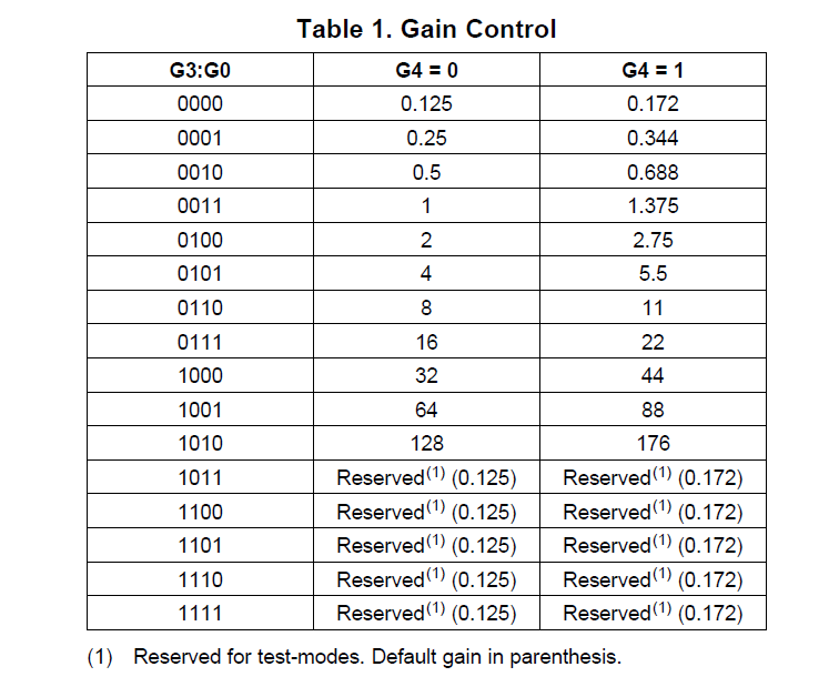

I am trying to simulate the PGA281 in LTspice. Gain Adjustment simulation of the PGA281 is not as per datasheet recommendation (shown in the below table ).
The problem is when G3:G0 bits set for a particular gain, the actual Gain from the output is previous immediate gain in the below table, like wise row number 2 to 10 in table misbehaves.
For example, if G3:G0 bits set for unity Gain, The actual output Gain from the output is 0.5 .
Also G3:G0 setting 0000,1010 and greater are not working correctly for set gain.
I have also tried in Tina Ti tool the same behavior exists.
Could you check it and send us the corrected Spice model ?
