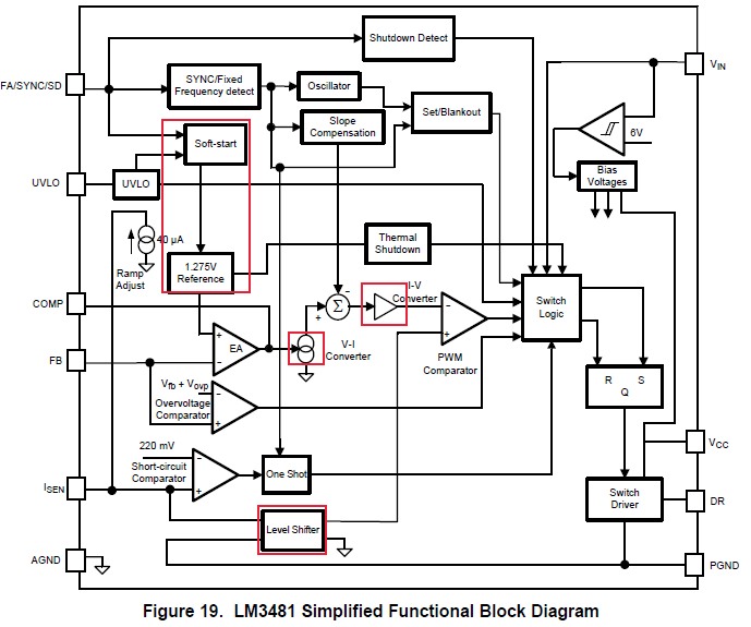

I have meet a problem about the soft-start of LM3481.
The PSpice model of LM3481_tran cannot realize the Soft-Start function.
While I change the model parameter from 8u to 300u at the position of blue area,it can realize Soft-Start function.
So I want to ask if you can provide me the internal model of the LM3481 other than packaged model.
Our company is doing a project about the automotive electronics.We need the function.

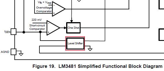

Besides,can you describe the Level Shifter in the LM3481? Beacause I think it's not a constant.
Waiting for your reply.

I need to realize the startup process in simulation. Maybe it's be realized by PSpice or Simulink, so please tell me the true startup process of LM3481, other than a packaged PSpice model.
Besides, I think the softstart is related to 1.275V Reference. I suppose it's a ramp signal not a step signal.
Please tell me more details.
Thank you very much.
The level sifter is basically equivalent to the normal COMP to PWM offset. Instead of subtracting this the value for the COMP signal it is added to the current sense signal. In current mode control these are equivalent actions. This value can be estimated to be around 600mV as seen in the datasheet specifying the minimum COMP voltage.
Can you please clarify what you mean by the startup process? The UVLO pin needs to be above the specified rising threshold. The easiest way to get an idea of the start-up procedure is to use one of the models that is online.
