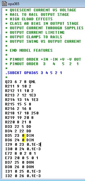

I am having a problem with the OPA365 in simulation (and possibly in a real life circuit) when dealing with a common mode step voltage on the power supply.
I put the model in LTSpice (sorry:-) and configured it for a unity gain buffer. I put 1V relative to the opamp ground on the IN+ pin. I then step the 4.096V supply from -25V to +25V (the differential voltage does not change but relative to the simulation ground it does step). The input to the opamp stays at 1V relative to the opamp ground but has a small 1uV disturbance on it. The output of the opamp responds with a decent size spike.
This response from op amp doesn't make sense to me.
Is this the expected response from the opamp or is this a modeling issue? Any insight would be appreciated.
I am using this part in a current sense circuit which is a diff amp and I am seeing a similar response from the real circuit. I was surprised to see this response in a simple unity gain buffer sim but that's why i am questioning my knowledge of what is going on.
