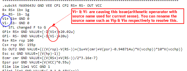

I was trying to define a new macro based on the model downloaded from
www.maximintegrated.com/.../MAX9643U.LIB
The New Macro Wizard gives me an error message "Undefined parametr or possible use of function before definition: I#VI.
I spent hours trying to debug the problem, but still have no clue. Please help! Thank you!
