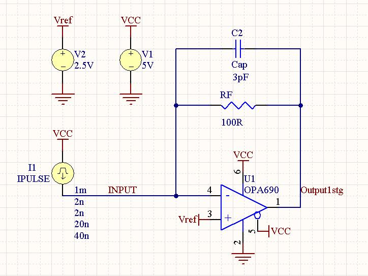

I'm currently trying to use the OPA690 Spice model  in Altium Designer 2004 but it doesn't work. Altium accepts the model, no import errors of the model file but when I try to simulate the result in incoherent. As if the amplifier was not working or supplied.
Could anyone help me?
Thanks.

    Issues with Spice models are handled by our eLab group. I am moving this thread to their forum. As a first debug step, can you please post a screenshot of your simulation schematic showing the OPA690 connections? Also, sometimes the last lines of code are truncated while importing. Please verify that the following lines of code appear after the line '.ENDS OPA690' in the imported model.

  • I've check my model and it's not truncated, all those lines are still present.
    Here is my schematic:

    Since I am not familiar with Altium Designer 2004, I am not sure what might cause your problem and not sure how to help you.
    All being said though, could we do several things so that I can help you further:
    1. From your schematic picture, I am not really sure if pin 2 is gnd or VCC. Could you double check your pin connection just to make
       sure that you don't flip VCC and GND etc etc.
    2. When you run operating point (dc bias) what is the quiescent current coming out of the amplifier?
    3. Could you post the output response of the test bench you attached?
    If everything is correct on your connections etc etc, I am suspecting that there is incompatibality between pspice/tina and Altium.

  • Hi everyone,
    it seems that the problem was from my version of Altium. I tested the same schematic with Altium 6 and it worked.
    Thanks for your support.
