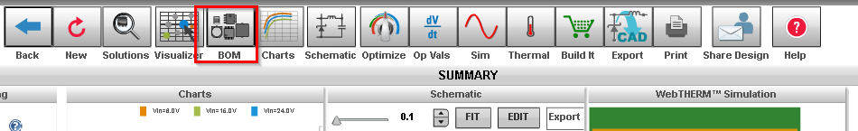

Hi Team,
Is there a way to import a FET into WEBENCH and do we include FETs from other vendors?
Regards, DIego
  • Hi Diego,
    Please find the below steps to check the list of mosfets from different vendors.
    1) Open the design
    2) Click on the BOM option
    3) Click on the  “Select Alternate Part ” to see the list of Mosfets from different vendors and its other parameters.
    Alternatively you can go to the schematic , click on the Mosfet symbol and then click “select alternate component” to see the list .
