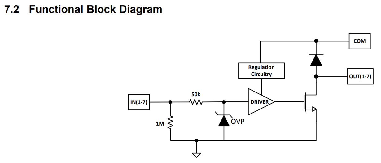

I've been modeling this part and noticed the input pull-downs were pulling more current than I was expecting. After running some simulations to investigate, the model seems pretty clear that each input channel has 300kOhm of resistance.  The datasheet only shows there is a 1Meg resistance to ground.  Is this a modeling error?
