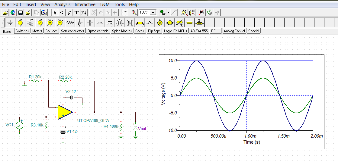

I’m have convergence issues using this model in even simple circuits - for example a simple inverting amplifier with unity gain ( Rf= 20K, Rin = 20K, OA (+) input to god = 10K, load = 100K. I’m running the OA of a +/- 12 V supply.
I’m able to get this circuit to converge in DC and transient analysis by varying the load resistance - reduced it to 10K.
I also increased the supply voltage from +/-12 to +/-15 volts
I took this simple circuit when it converted and change the input resistor from a singe resistor to two series resistors with a slightly different value and it no longer converged.
Is the OPA4188 model inherently hard to use?

    The OPA4188 simulation model is a complex model and an early version of what we refer to as our Green-Lis model. This early version can present a conversion challenge under some conditions, and with some Spice simulators.
    A newer version of the OPA188 simulation model has been in development. We refer to this version as the OPA188_GLW model. It is still a beta version, but once it is fully tested and veted it will replace the OPA4188 model currently on the web page. Note we use the OPA188 model for the single, dual, and quad version of the product.
    I am sending you the TINA Spice circuit using the new, OPA188_GLW beta model. You can copy and paste it into any TINA circuit. Give it a try and see if it converges more readily for you. If you still have problems, let us know.
    Regards, Thomas

  • Sorry - I downloaded the schematic: OPA188_GLW_Test_01.TSC. I've got it running now. Thanks.
    If you could lead me to the simplest explanation of how to incorporate this model into the TINA-TI Spice library, it would be greatly appreciated
  • I played around with the circuit I was having problems with and it works fine with the OPA188 model. I was doing unit step response analysis, and things look like they should. Thanks again.

  • Thanks. When I opened the schematic you gave me with the beta model, it auto-saved that schematic on the c-drive. I did the copy/paste method you described into my schematic and saved it. Again, it worked great, and thanks.
