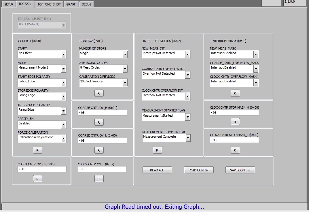

2, Can you give me some advice how to configure the software TDC7200 GUI so that it can work with TIDA-0066.
