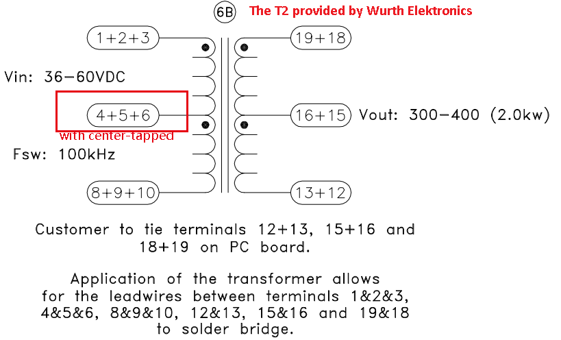

TIDA-00951: The lastest version of transformer T2 provided by Wurth Elektronics is 750343382R02,which does not match the TIDA-00951 schematic and PCB provided by TI.
Part Number: TIDA-00951
Hi,TI Engineers.

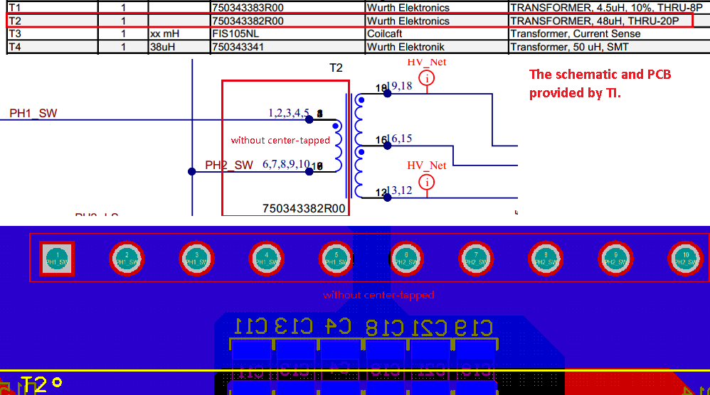

Recently,I was doing a device like UPS,using TI's TIDA-00951 design.The design of transformer T2 supplied by  Wurth Elektronics is R02 version,which is defferent from the schematic and PCB provided by TI.
In the schematic and PCB provided by TI, the  primary coil of T2 has no center-tapped.But in the transformer provided by Wurth Elektronics,the primary coil of T2 has center-tapped.
So,I need  the lastest schematic and PCB of TIDA-00951.Can you provide it to me?
See the photo.
    This latest transformer use center tap to reduce proximity losses in the transformers. You do not need to terminate the center tap on the board. Please cut the pins 4,5,6 so that they dont touch the PCB you developed. Apart from that you can use the same PCB for working with this transformer.
