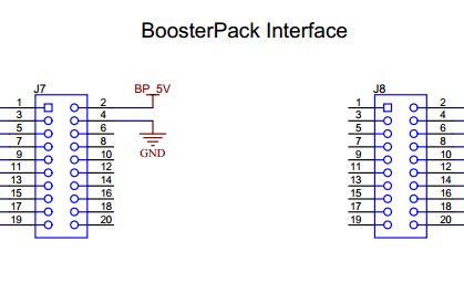

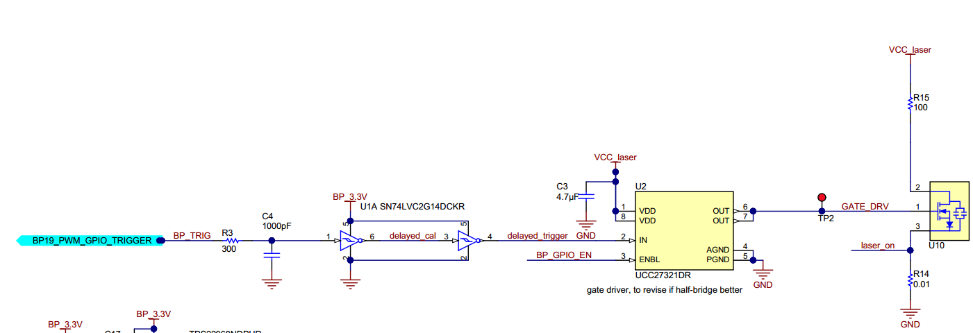

I've recently started working on implementing TIDA-00663 LiDAR reference design and I  came across some obstacles, enumerated next:
1) What is the function of ext_15V? I don't see any connection to this pin.
2) About the laser driver (UCC27321D) I had a huge problem. First, I only soldered the TX part of the circuit (image below) and when I connected it to an external Vcc_laser = 10V (power source), while keeping ENBL floating (internally pulled-up), it basically overheated and released a white smoke. I can assume it burnt. I already verified and all the pins are correctly connected. Furthermore, when using the MSP430F5529LP connected to the TIDA-00663, and if I connect Vcc_laser for e.g. to the board +5V pin, the board automatically disconnects from the PC. Can someone please help me understand what is going wrong? Is there something that I'm missing or doing incorrectly?
3) Is there any C++ or C code for triggering the Laser using nanosecond pulses? I used Energia but digitalWrite() is too slow and introduces delays of about 1-2us and the solution I found is to program at a lower-level. This is my code:

4) Is there any SPICE model for Schmitt-trigger SN74LVC2G14 or similar? Or is there any other way of simulating it ?
