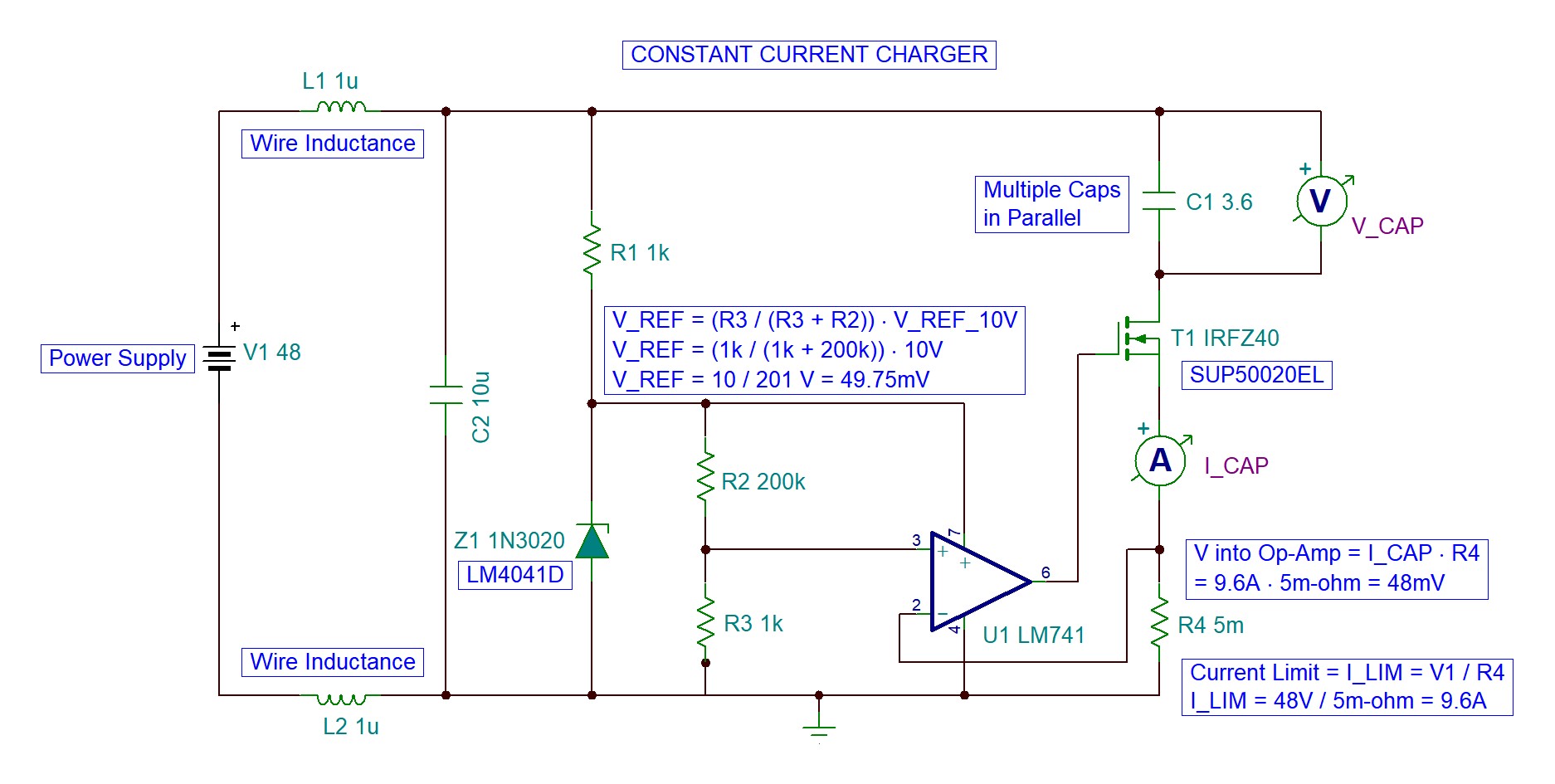

I am designing a constant current source (technically sink in my case) and wanted to make it as simple as possible, accept a large input range, and be inexpensive while being adjustable for different currents by changing gain resistors and the MOSFET. I designed and simulated it in TINA-TI and got it to work for my needs, but when I simulate it on a breadboard (used a different MOSFET, but I didn't see mine in TINA) it didn't hold a constant current.
I am attaching my schematic, simulation results, and spice model to make it easier to help.
I am not opposed to changing the op-amp if there is a better instrument op-amp, etc. I just choose that one because it seemed like it could work and was inexpensive.

  • I modified the design slightly and amplified the voltage from the shunt with another LM741:
    But now that I have 2 op-amps, do you think it is a good idea to just use a better single op-amp?

  • Sheldon,
    The input range for LM741 does not include ground (pin 4). Datasheet recommends 3V higher than ground for input.
    Change op amp search to include rail to rail "IN to V-" checkbox
    www.ti.com/.../products.html
    LM321 is the low cost device.
    You should also consider a bypass cap for op amp supply and add option for frequency compensation in the output lopp.
  • Hi Ronald,
    Thanks very much for your reply!
    I can't believe I overlooked that! I'll be to read the datasheet more carefull next time!
    Thanks for the LM321 suggestion for an op-amp. I'll need to simulate it and double check it works (I think it will). Great idea, yeah I need to add a bypass cap (100nF should work).
    Yes, I'll try doing the frequency compensation. Do you mean I need to modify my schematic or do I need to do that in the search option?
