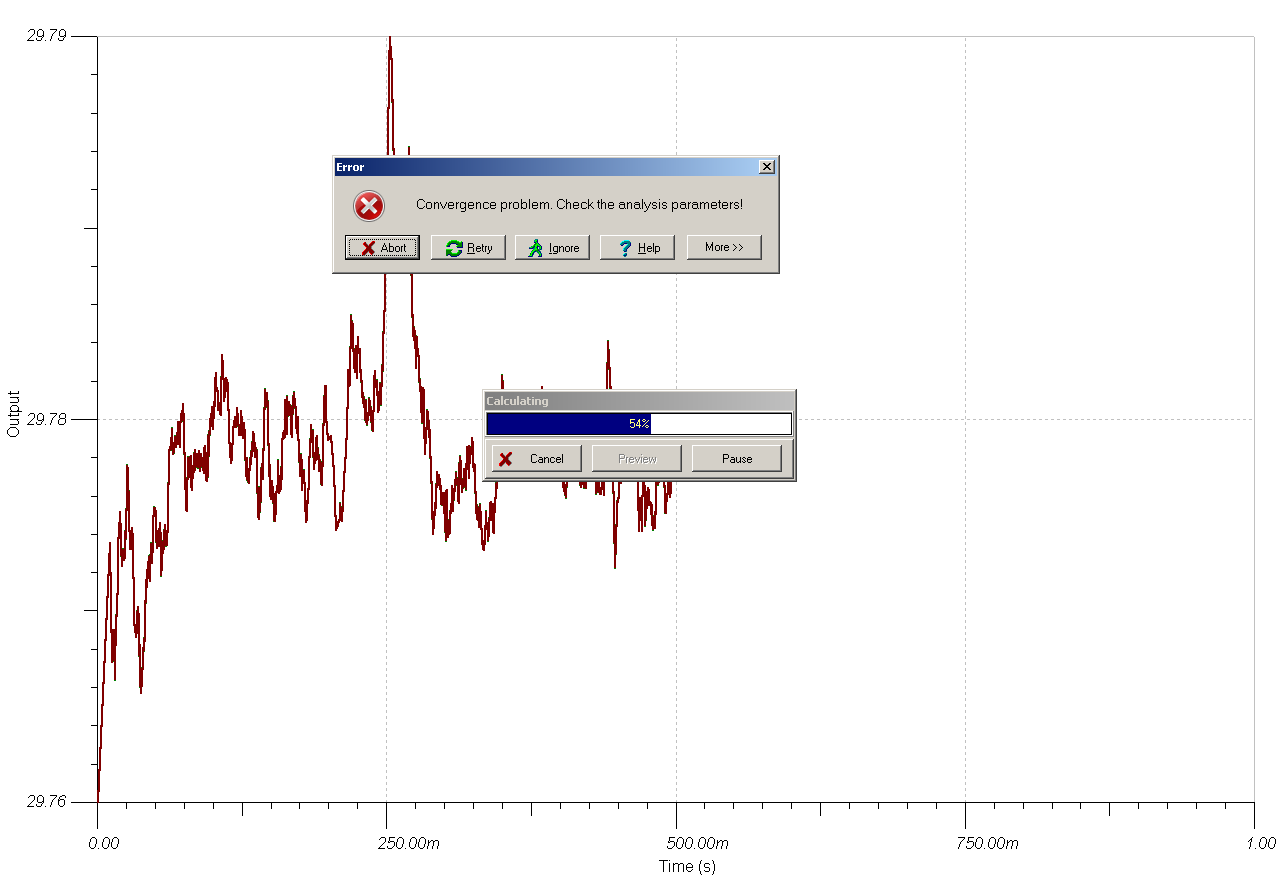

I have been trying to analyze a section of my circuit, but I can't conduct a transient analysis without getting the "Floating Point Overflow" error. I'm unsure of how to fix this, but I have uploaded a .zip file of my circuit. If anyone knows how to fix this, it would be much appreciated.Firefly_Input_Analysis.zip

    Could you please confirm the TINA-TI version you are using?

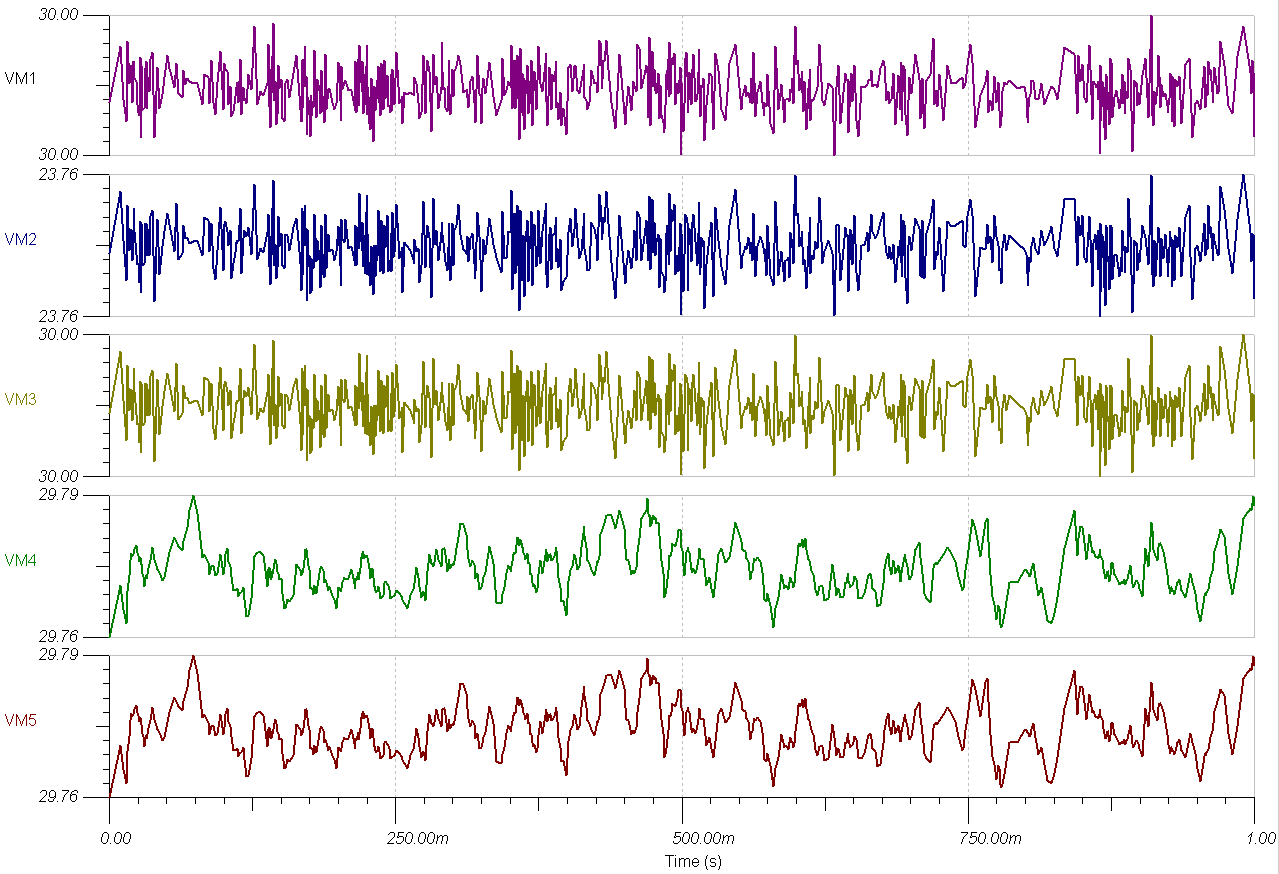

    I am not getting such error in latest version of TINA which is Version 9.3.150.328 SF-TI.
    Though it gave convergence failure and it was resolved after increasing TR maximum iteration number to 40 from 20.
    Kindly let me know if you have any other questions.
