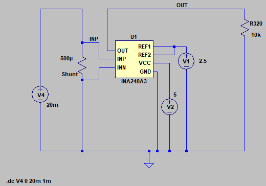

I have imported the INA240A3 model into LTSpice using the .LIB file.

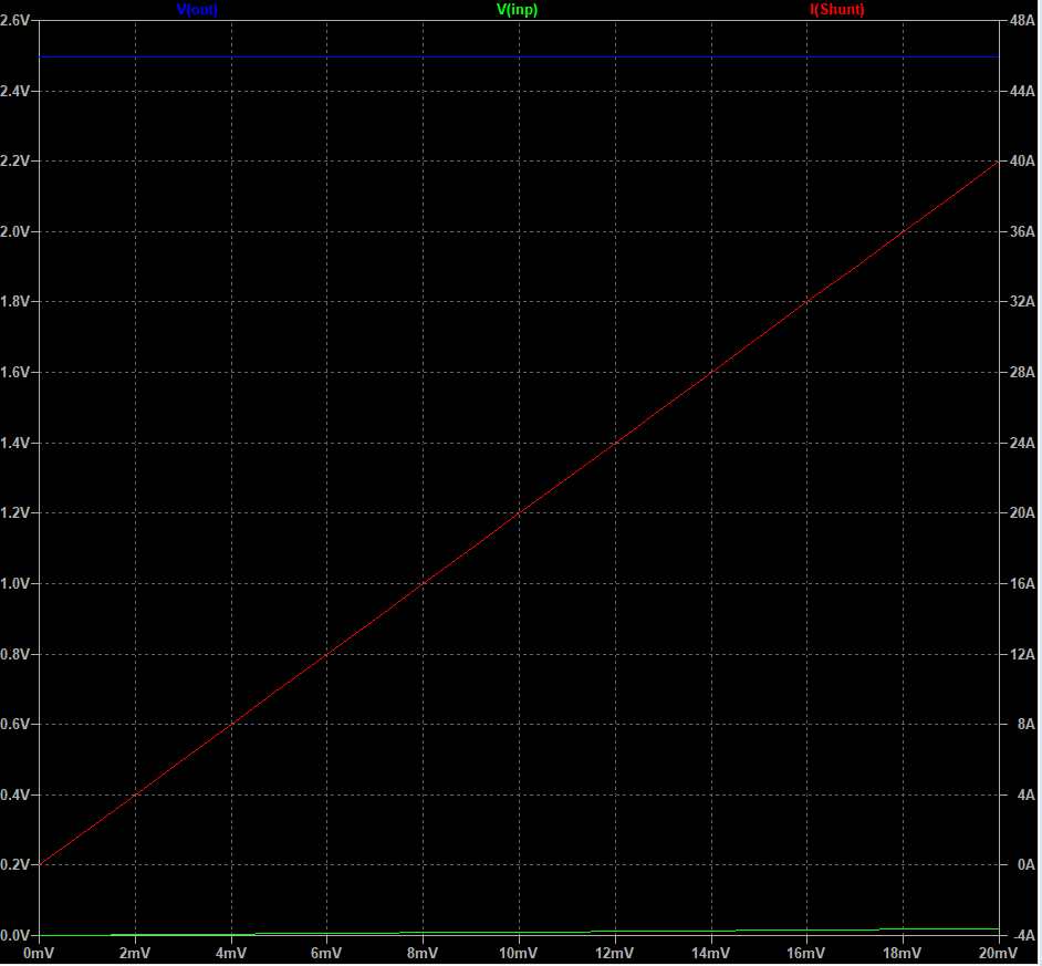

Unfortunately I am not getting the expected behaviour of the model.
The input should be amplified by factor 100. Yet no amplification can be observed.

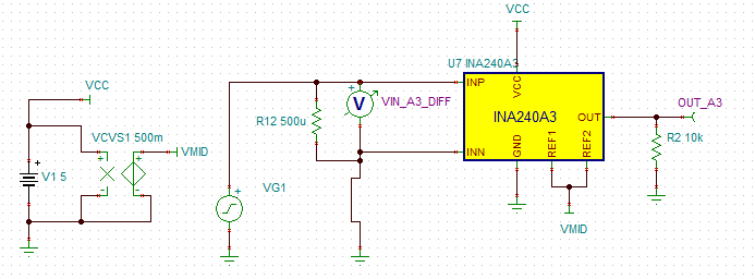

  • I duplicated your circuit in TINA, and it seems to work as expected.

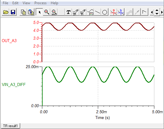

    In the TINA circuit below, the input signal is a 10mVpp sine wave with a 20mV DC offset..
    The output should have a Gain*Vin = 100*0.01 = 1Vpp output, with a Gain*Vin_dc + Vref = 100*0.02+2.5 = 4.5VDC offset.
    This is what is shown in the plot below. The output is slightly clipped because it is bumping against the upper rail.

  • Thank you for the quick reply.
    Somehow a DC sweep in LTSpice doesn't seem to be possible with this model.
    But a transient analysis works.
