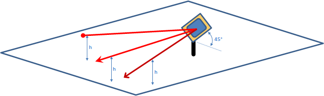

I would like to include a DMD into my optical set-up in my laboratory, for application close to single pixel imaging. Do you provide custom solution for this kind of integration ?
It needs to be tilted 45° to the optical table, so that the output beam is in the same plane than the input beam.

    We do not provide anything made for this specifically, although we have made such mounts in our machine shop for our testing.  It is not difficult.
    Typically a plate that mounts the DMD board with standoffs is used, and then that plate is mounted to a small rotation plate mounted vertically (for making sure all the h's are the same).  Then another plate is made to mount the controller.
