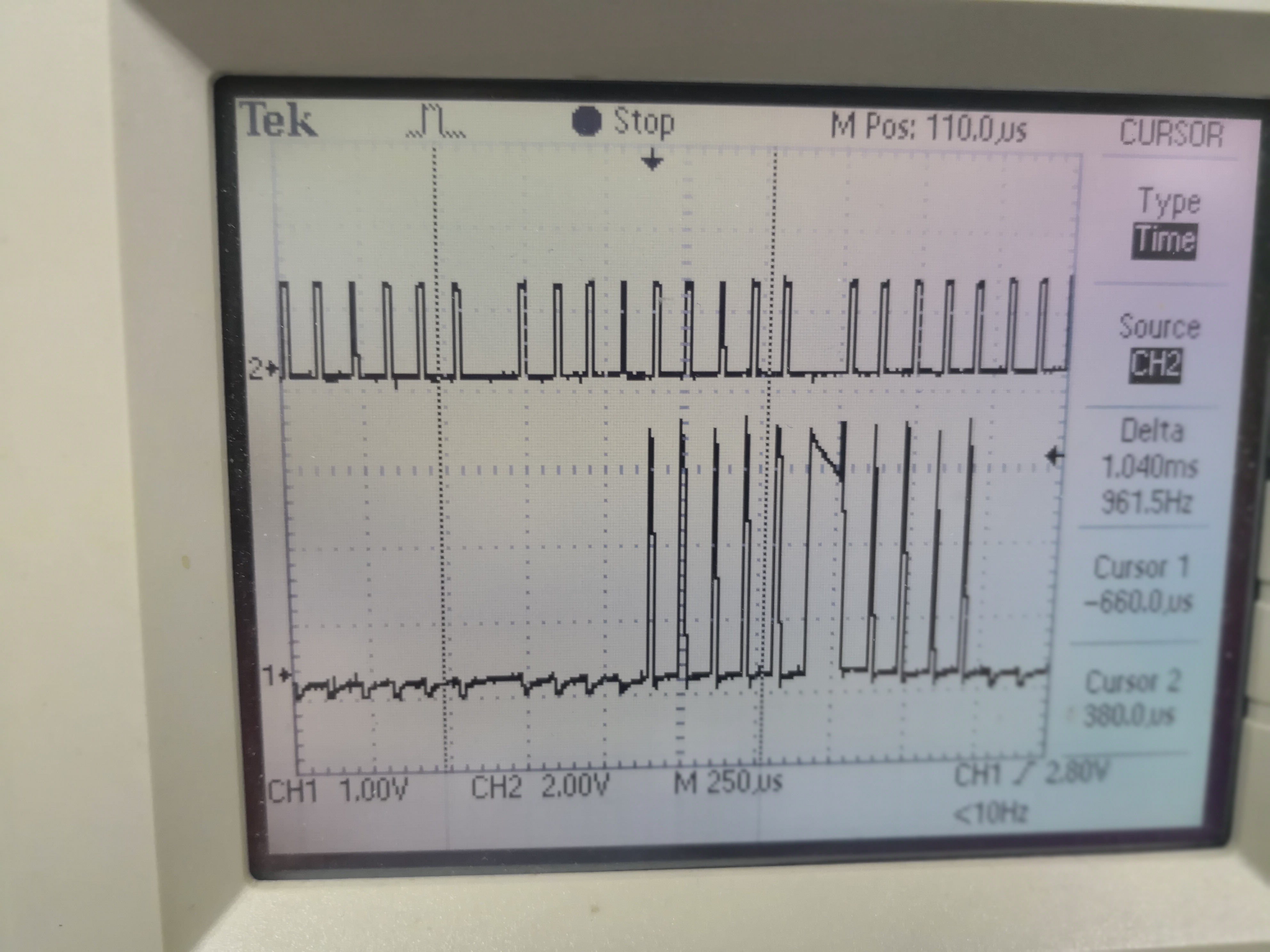

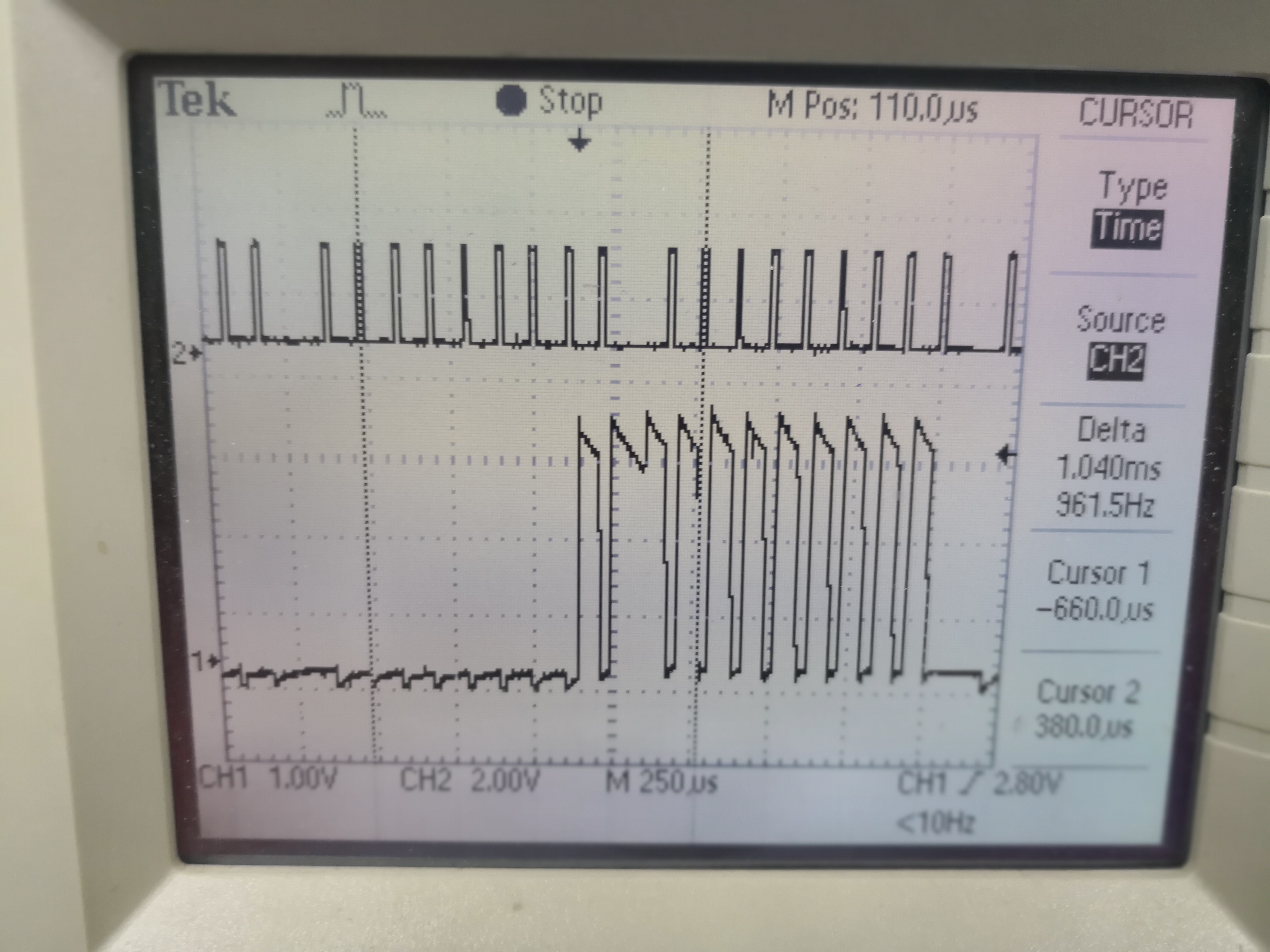

    1)for(U16 n=0;n<16;n++) , seem it will send a 16bit data. I can observe a 16 bit waveform around 2.1ms
    i would like to ask if the tx packet is 1 start bit and then 7 bit content and 1 stop bit ?

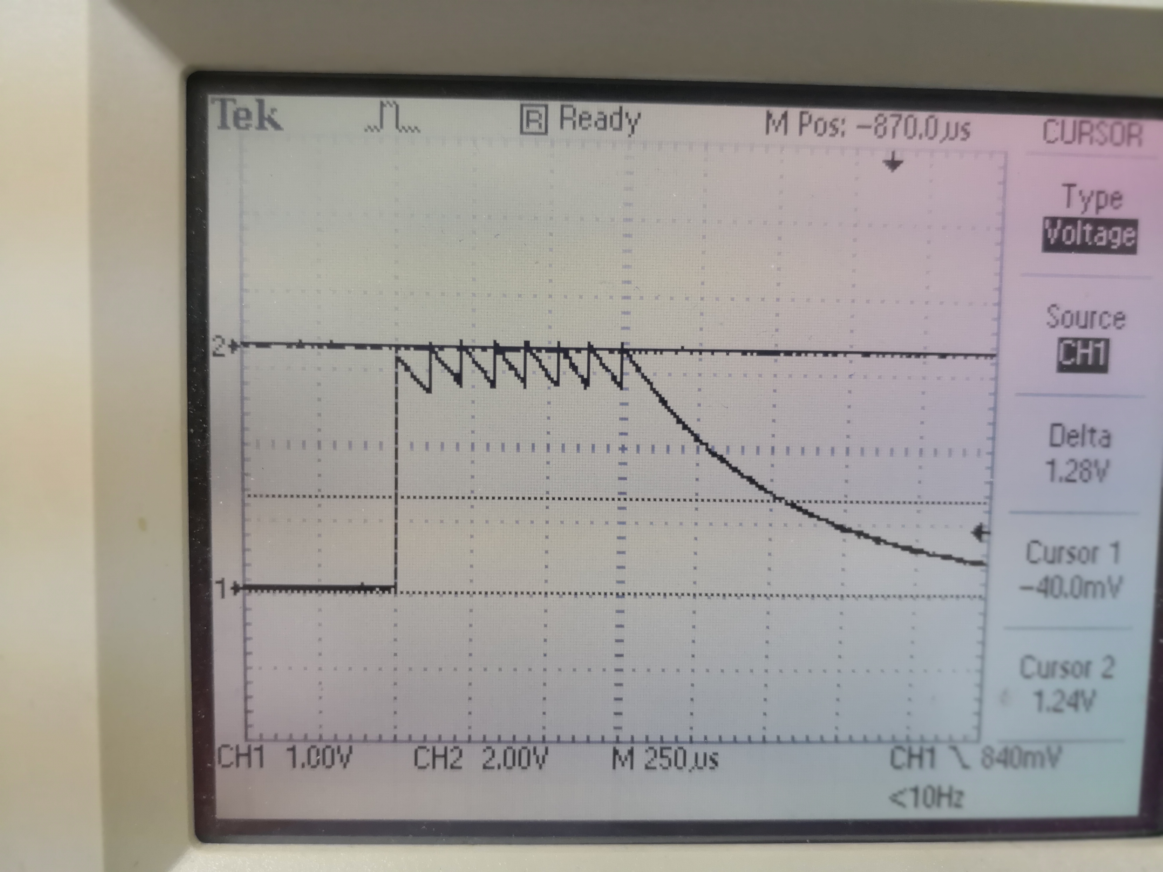

    2) For the RX part, i have never get my waveform below 1.27V
    According to datasheet, it Says "The exact voltage reduction depends on the intensity of IR light as well as the relative timing
    of the bit pulse versus the polling bit time slot"
    I didnt use TSPF6200 as suggested.
    attached are waveform of TX and RX
    thanks
    Jeff

    it is impossible for me to help you debug all your problems when you are using different LED, I have no idea how sensitive it is.
    Have you put the LED directly next to each other to ensure max. IR light coupling into the receiver?
    if the LED is around 900nm, you can just use a Remote from a TV or SAT receiver (i used a cheap universal remote) and use that as TX to verify your RX part; at least you should be able to see drop below 1.27V.
    Note that the challenge is to have TX and RX at the same time.
    So use a continuous TX, eg a few seconds with no breaks to ensure TX sequence is long enough to hit your RX window.
    Milen

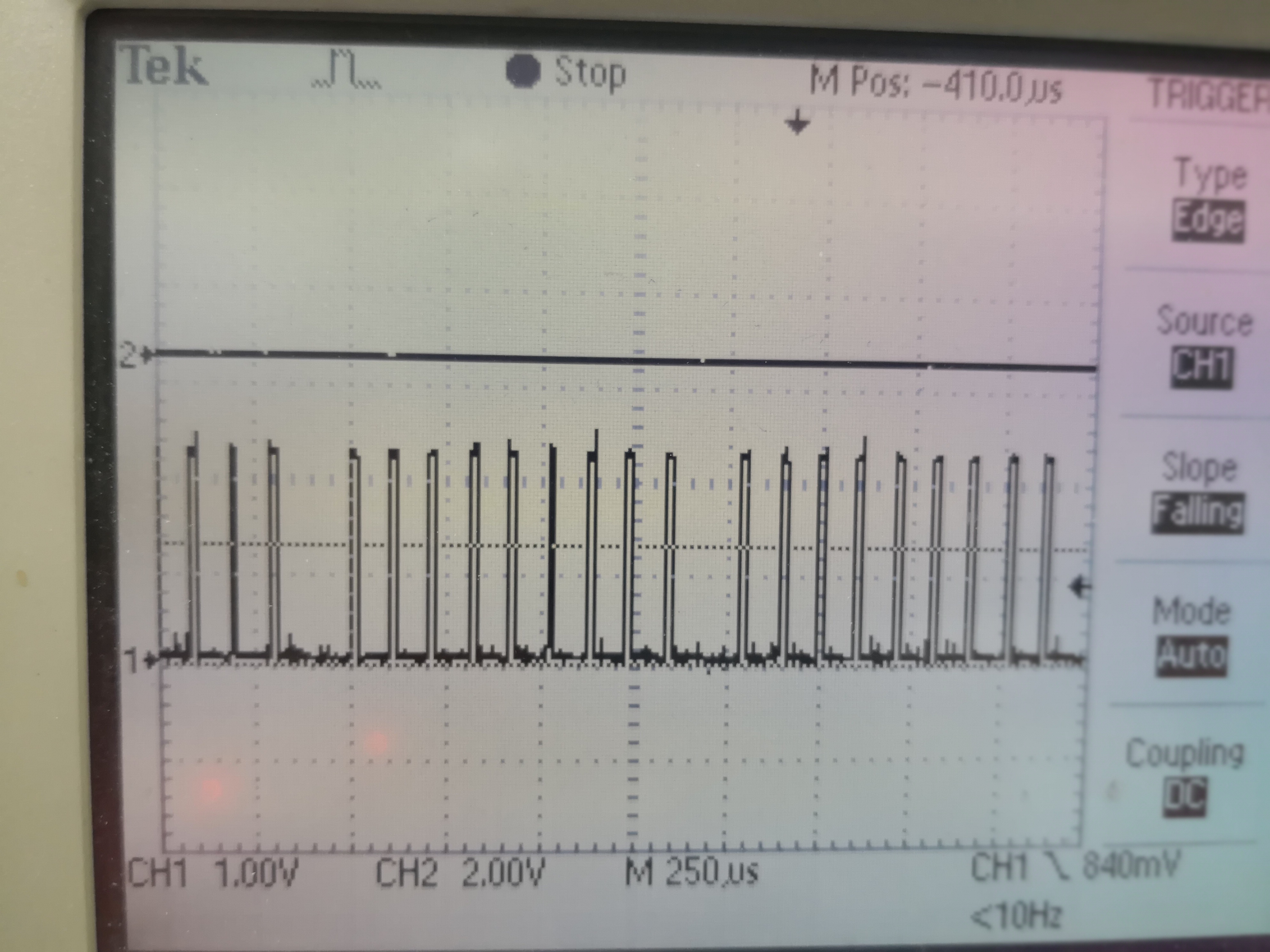

    for the TX (or actually the RX part), what i can do is to adjust the value "K" so i try to modify the value of K to be higher say "50"  so that the TX window is much higher than the RX, and i have set the adress to be '0"
    and the problem is as below:
    and the SCS result
    it seems that the "false detection" of the start bit will cause the error,
    so how to solve it?
    And i do not understand how the value of K to be assign in RX part,
    for provided RX . k = 7 , and so only 6 bit will receive...............
    thanks if you can point out  my problem ~
    thanks
    Jeff
  • Jeff,
    are you using CC1310LP to transmit under SCS?
    I mention in the UG that you need to enable the Higher Driver strength (available only on a few pins of CC1310) to get 8mA, see Chapter 3.5
    Higher TX current will help you get larger voltage drop on the RX side.
    Same effect you can achieve if you put the TX LED and the RX LED closer together.
    If both of the above don't help (=the voltage does NOT drop below 1.27V on the RX side), then your next option is to use an external Voltage divider which creates a Reference voltage above 1.27V DCOUPL. See Ch. 2.5 of UG: "if an external resistor divider is used (allowing to extend the IR link range), then the REF and the IO1 lines are necessary."
    K=7 was used to detect a wake-up signal of "0x0F" and is really optimized for Ultra low-power.
    The implementation of a protocol over the IrDA PHY layer is outside the scope of this TID.
    So after detecting the wake-up, you will have to take care of the data bytes you want to transmit, the message formatting, the timings between TX and RX and so on.
