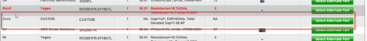

A customer brought to my attention that Webench did not allow them to change their LM5118 design VCC cap from the "custom" 1uF default to an actual part number. This is likely because it lists an ESR of 0ohms so no alternate components show up. Could you please look into this? Looking at the datasheet, a 1uF, 16V or 25V X7R cap should suffice for most applications.
