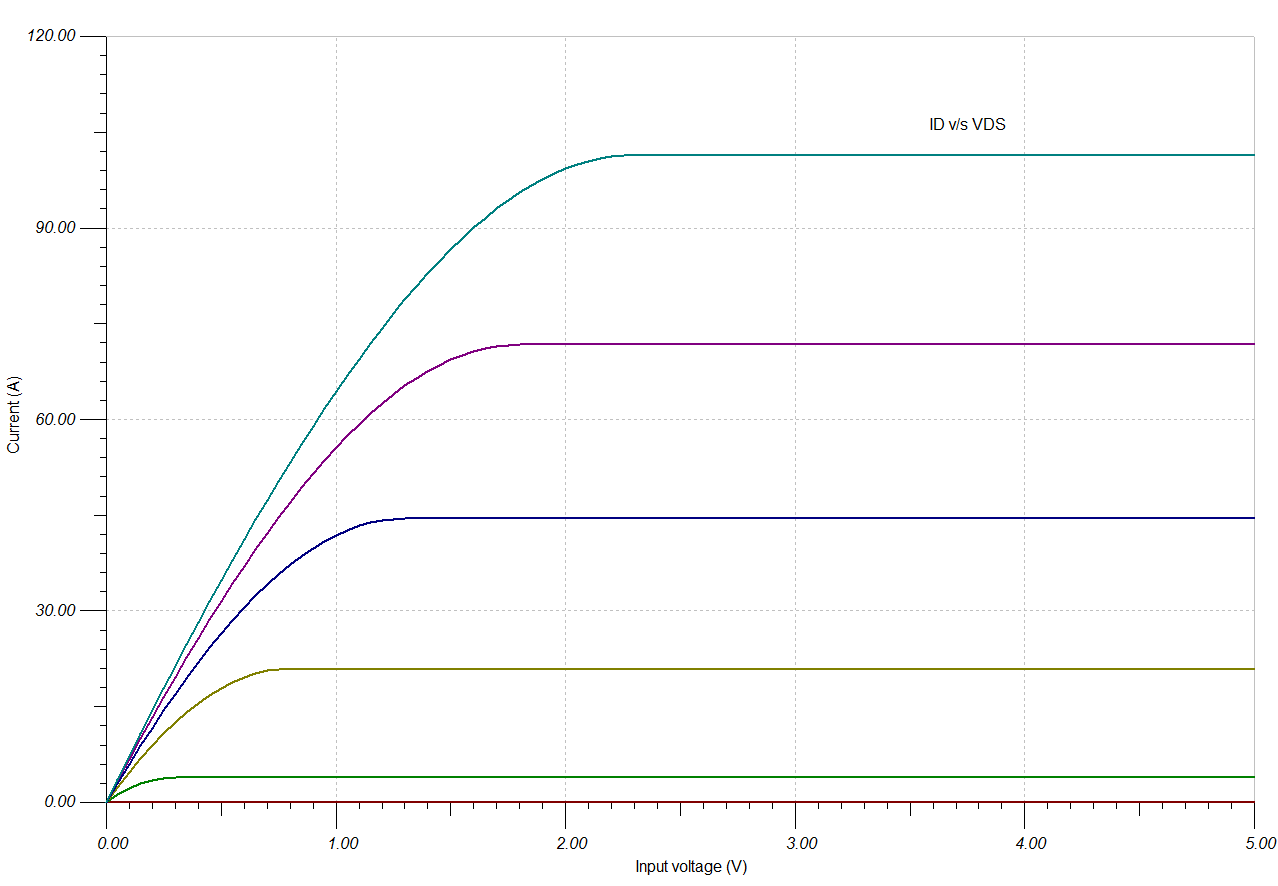

SPICE model MOSFET IRFH3707 from INFINEON is not compiled into TINA TI. What's wrong? What to do?

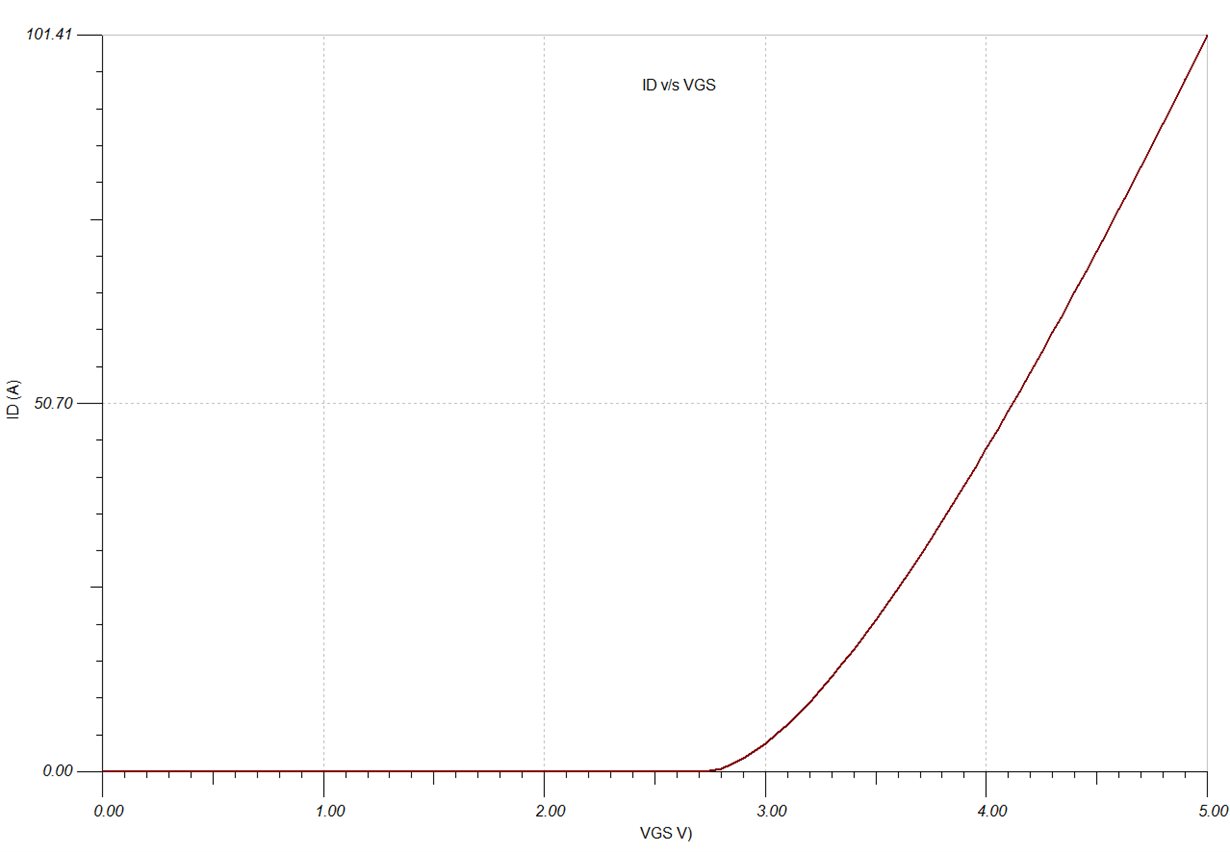

  • Hi Alex,
    To compile the subciruits into TINA netlist editor, please keep the first line as Blank as TINA netlist editor ignores the first line.
    Please find attached the .TSM file for IRFH3707. Please note that I have removed the complete definition of SPICE thermal model sub circuit(it is not used by the main subcircuit).
    I have also simulated the MOSFET for it's characteristics. Below are the obtained results:
    Macro:
    IRFH3707.TSM
