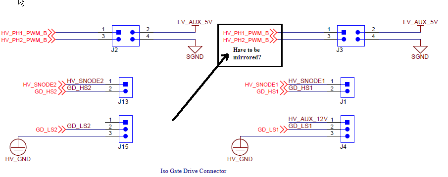

Part Number: TIDA-00951
I have a question about the switching of the the HV Mosfets. I don't understand why the PWM signals for the mosfets on the HV side are not mirrored (see picture below)?

Please flip the pins 1 & 3 on connector J3 for your testing. I will upload the updated schematic indicating the same.
