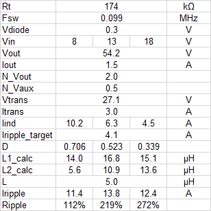

    Although, when connected this way, won't the net primary-side inductance (10µH || 10µH = 5µH) be less than suggested by the LM5022 datasheet?  The datasheet recommends targeting a ripple current of 40% for the lowest input voltage.  It seems as though it would be better to use an inductance of 20µH instead of 5µH.
    The way Pulse did the transformer is terminating each end of the winding on two pins, the inductance is still 10uH. Even it's two windings in parallel, the windings are wound on the same core, the inductance will be the same.
    Yes, the ripple current percentage you mentioned is correct, the percentage has to do with modes of operation (CCM/DCM), also more ripple current will result in more AC core loss, it's always a trade off.
    But I evaluated this Pulse transformer, it will work with the spec I specified on PMP20058.
