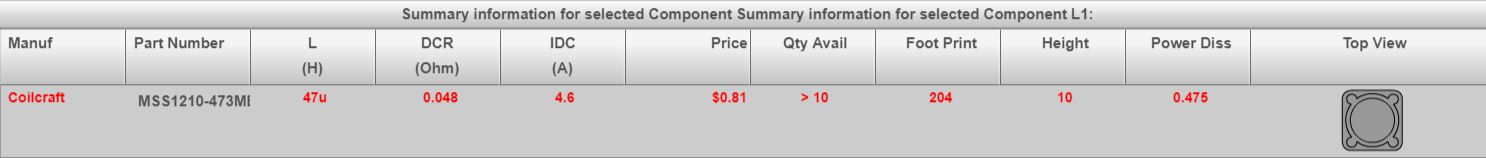

In WBENCH when i look at the parts being offered, i wonder whether the coilcraft parts are correctly specified?
WBENCH is showing a coilcraft inductor (MSS1210-473MEB) with the following parameters -

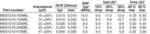

The Coilcraft datasheet shows the following parameters-
It appears that the value for Isat(A) has been used in place of Irms(A).
Am i reading correctly?
