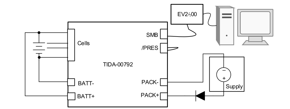

I was evaluating TIDA-00792 for my personal project.
The board boots up fine, but i am facing a few issues.
1. My setup looks like above and i am in the process of testing charging of my 14s8p pack made from NMC cells, the problem i am facing is as soon as i toggle chargefet, current rises but it stabilizes at 0.5 amp even though the supply is set at 10 amps CC. I have loaded the default settings and changed the following

    1. There is nothing in the design which should limit current. A BMS system is typcally designed to provide full current up to the configured threshold, then cut off and follow the supported recovery method. The issue is more likely circuit or equipment than configuration. You should look for the voltage drop with a meter or scope. Find the location that the voltage changes unexpectedly. With an 8P pack the cell voltage would not be expected to change much with charge current. If some protection is cycling it may have some PWM effect of apparently limiting the current and that should be easier or necessary to see with a scope.

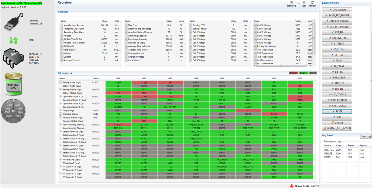

    Also attaching the status registers.

  • Hi Nakul,
    See your picture above, notice the Operation Status A(low) register, the DSG and CHG bits are off showing DSG and CHG are disabled. This is because in the Manufacturing Status(low) register FET_EN is low. Refresh or scan the screen to be sure it is a current display. Enable FETs if needed using the "FET_EN" button in the commands pane on the right. The command is a toggle command, so click once then update the window. At present there are no faults shown in the safety alert or safety status, so the FETs should be free to turn on if enabled.

    In your voltages table above, each result column alternately shows voltage on CHG_EN and DSG_EN. One would think you have enabled FETs in some manner to get those voltages. More normally the FET_EN is set and the FETs are on unless there is some protection event, the battery is free to deliver or accept current. However you achieved the FET_EN, when you had that condition the corresponding CHG or DSG output from the bq76200 are not apparently on.
