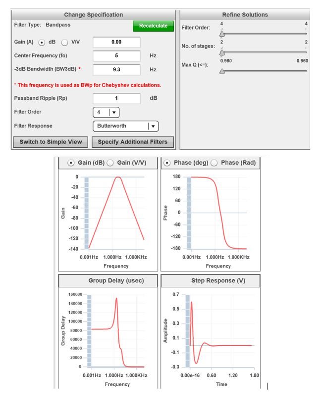

reading the TIDA-00489 PDF I was wondering, if the sensor layout is able to detect to several movements in a few seconds e.g. 1 movement per second. I think in my application 2 movements per second would be sufficient, but still, I'd like to know what the maximum is and if I can alter the electronic layout to be faster. In my later application, the system would sleep until a movement is noticed by the sensor, wake up --> increment a movement counter and immediately go back to sleep. After 10 mins or if 10 movements have been detected, the amount of movements is send to a gateway.
- So, how fast is the device in standard configuration?
- Can I adapt the filter parameters to get faster?
I hope I was clear about my question, if not, dont hesitate to ask for further information.
