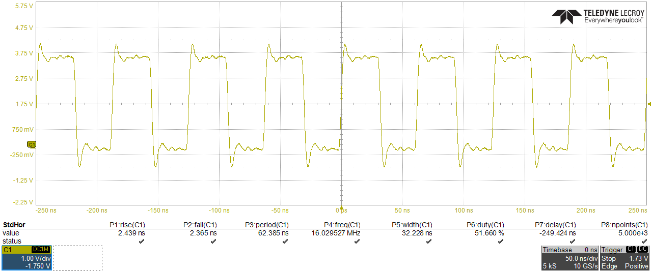

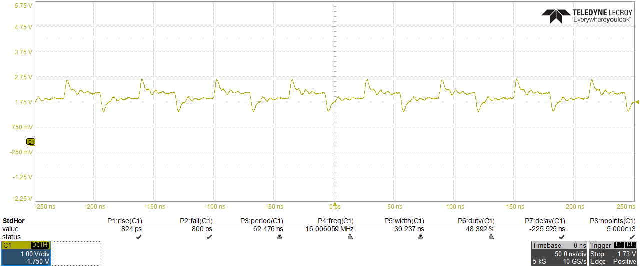

In the TIDA-00663 reference design, I've been using a 16MHz external CLOCK source from an MSP430FR5969 to the TDC7200.

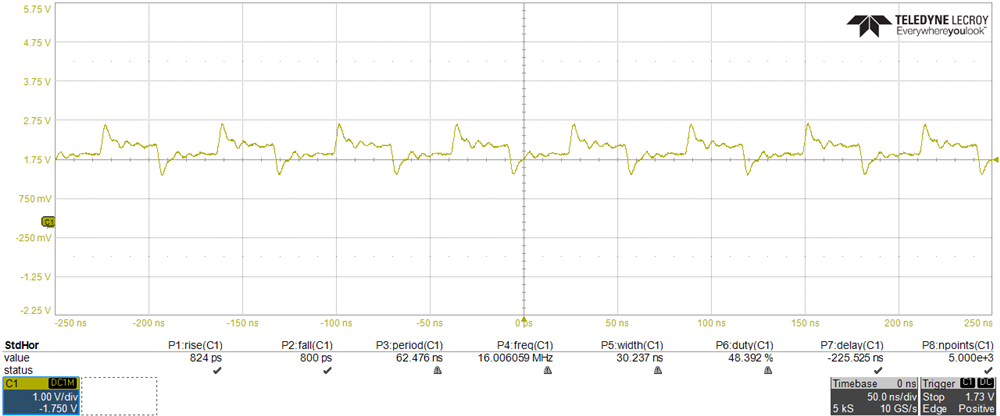

However, I've just noticed that at the OPA857 output, there is an oscillation with the same 16MHz frequency.
The PCB has every component soldered except the laser driver (U2) and the Laser (U10), as the respective resistors and capacitors

As a result, I get the following signals as, respectively, Clock and OPA outputs. One should note that if I increase the OPA gain to 20kOhm, naturally the output oscillations are also amplified.
If someone could help in finding the source I'd gladly appreciate it.
