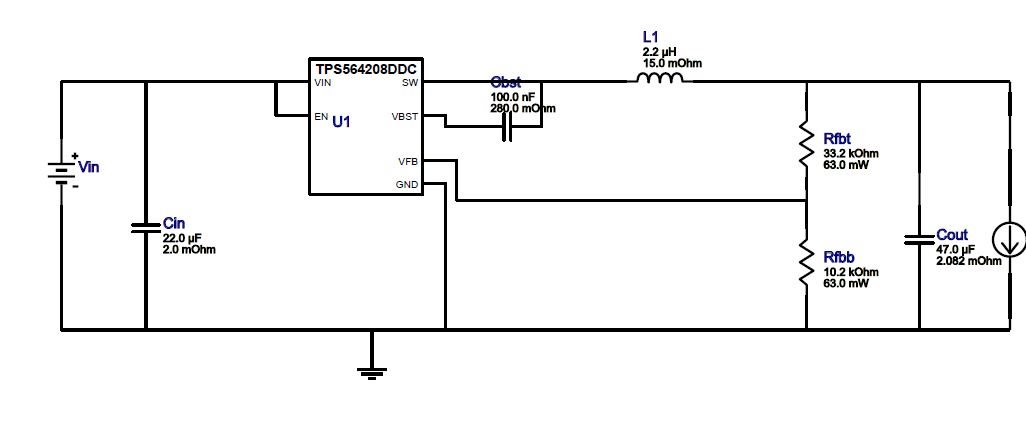

Part Number: TPS564208
Hello all,
I am using TPS564208 circuit as per the webench suggestions i am using 33.2 K resistor as a feed back to get the output voltage 3.6V input is 8.4 V and output i achieved 3.6 V that is fine as per my torch requirements, input and output capacitors aluminum electrolyte 47uf/25V.
My torch is taking 2A current,but through this circuit i am not able to operate torch on 2 A current,only up to 1 A only get it but as per data sheet it is giving 4A output current.
What values i have to change to get output current up to 4 A, any suggestions
