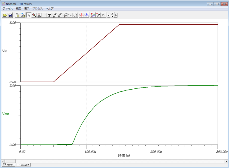

Hi Team,
There is "TPS73250 TINA-TI Transient Reference Design" in the following link.
http://www.ti.com/product/TPS732/toolssoftware
The result of ramp-up time using above is the following (~150us) however datasheet shows 600us(typ).
There is large difference between TINA-TI result (~150us) and electrical characteristc (600us) in datasheet.
I changed RL and Cout of TINA-TI schematic same as test conditions of tSTR however the result is almost the same.
Sould we consider electrical characteristc in datasheet as correct?
