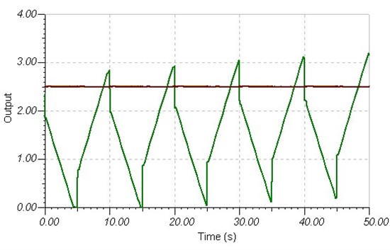

Hi all,
I need to save the transient results of simulation as text (ascii) file for further numeric analysis. Is that possible with TINA-TI v7?
Thanks and Regards,
Massimo
  • From TINA's waveform viewer you can export a text file of any waveform. Go to File ->Export -> As text.
    Here's a transient waveform plot:
    And here's the text file:

    41.338861200001    2.5    1.69987651620067
    41.838861000001    2.5    1.48087681415745
    42.338860800001    2.5    1.26293892627109
    42.838860600001    2.5    1.04606523794973
    43.338860400001    2.5    0.83025217942486
    43.838860200001    2.5    0.615494579154984
    44.338860000001    2.5    0.401787212846102
    44.838859800001    2.5    0.189125016133403
    44.999999200001    2.5    0.218164320565845
    44.999999400001    2.5    0.218164351946734
    45.000051800001    2.5    0.219027328725444
    45.000103000001    2.5    0.221149828489914
    45.000205400001    2.5    0.227341872353075
    45.000410200001    2.5    0.242564925794967
    45.000819800001    2.5    0.274459879041941
    45.001639000001    2.5    0.33477622389379
    45.003277400001    2.5    0.441203913825274
    45.006554200001    2.5    0.609525771651972
    45.013107800001    2.5    0.825361401050942
    45.026215000001    2.5    1.01394018128576
    45.052429400001    2.5    1.09148914308298
    45.104858200001    2.5    1.08970087864327
    45.209715800001    2.5    1.11382646761558
    45.419431000001    2.5    1.20784482099953
    45.838861400001    2.5    1.40022762399349
    46.338861200001    2.5    1.6271829422767
    46.838861000001    2.5    1.85290050205367
    47.338860800001    2.5    2.07752342147614
    47.838860600001    2.5    2.30104944894447
    48.338860400001    2.5    2.52348228796473
    48.838860200001    2.5    2.74482735011588
    49.338860000001    2.5    2.96508990571601
    49.838859800001    2.5    3.18427528161556
    49.999999200001    2.5    3.15732976787877
    49.999999400001    2.5    3.15732972488447
  • Thank you very much Rick.
    Massimo
