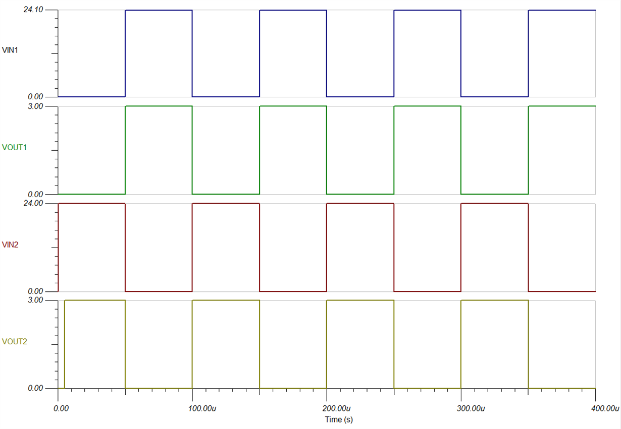

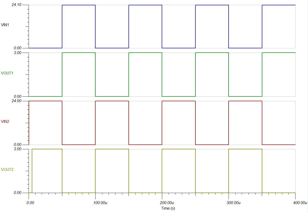

    In the schematic provided, the low side switch does not work as the voltage at VIN2 will still be 24V(even if you switch it off). There is nothing blocking the source. Also, I could not understand your query completely, but from my limited understanding, I have modified the circuit slightly to get the below output. Please let me know if this is what you expected. If not, could you explain in brief what exactly you expect at the output.
    I have attached the modified schematic for your reference.
    sllm391_low_side.TSC
    Karthik

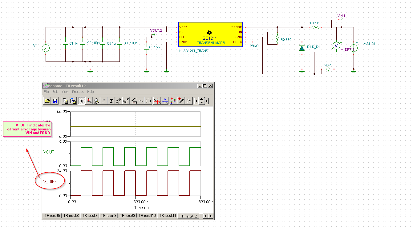

  • Hi Ronald,
    As mentioned by Karthik,we have debugged the FGND pin's behaviour for ISO1211 Model. Below is the same schematic that you tried for ISO1212 .
    Kindly let us know whether the below result is expected one and then we can modify the same for ISO1212.
    Ayan
  • Hi Ayan,
    this looks like the result I expected.
    Just as a remark: In my schematic the diode's anode was connected to the FGND pin, and not to the voltage source's GND, but I wouldn't expect any impact to the simulation result.
    Thanks a lot!
  • Hi Ronald,
    Thanks a lot for your confirmation. We will modify the same in ISO1212 model.
    Ayan
