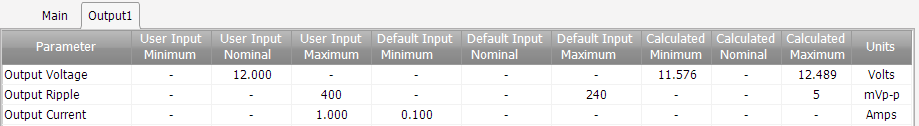

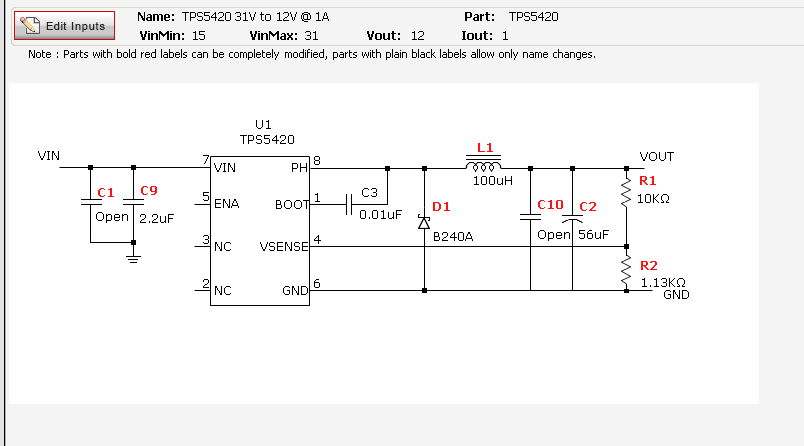

You should get the following:
Now, if you go into the Analysis tab, you will see that the calculated output ripple is 5mVp-p:
I don't know why SwitcherPro requires the user to enter 400mV as the
allowed max output ripple in order to generate a design with a 5 mV
output ripple. I need to follow up on that further.
