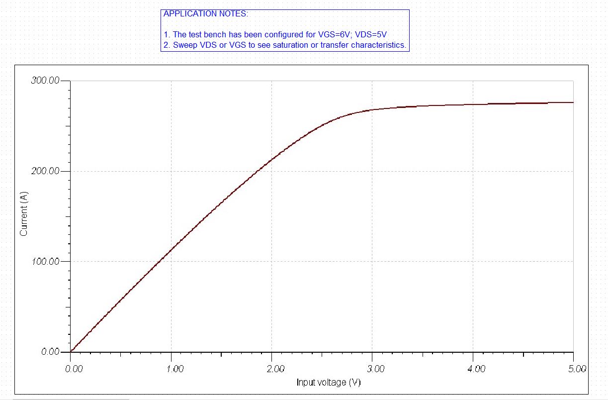

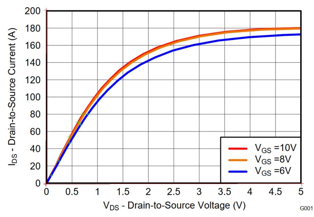

Please provide the latest VDS vs ID curve as I think the one given in the datasheet is wrong and it also does not match with the spice model results obtained from the TINA spice.

  • Hi Herman,
    Thanks for a response.
    I don't have any lab measurement as I am in a stage of designing and while doing the simulation I am able to see the difference between the datasheet curve and the Spice model.
    Form Datasheet.
    From spice Model:
    I just want to know which one should I follow as there is a big difference between the Idsat of both the curves.
    Harsh
  • Harsh,
    The datasheet curve is correct, I spoke with some of the technologists and they say the model is optimistic and loses accuracy above 0.5V or so. Please use the datasheet curve.
