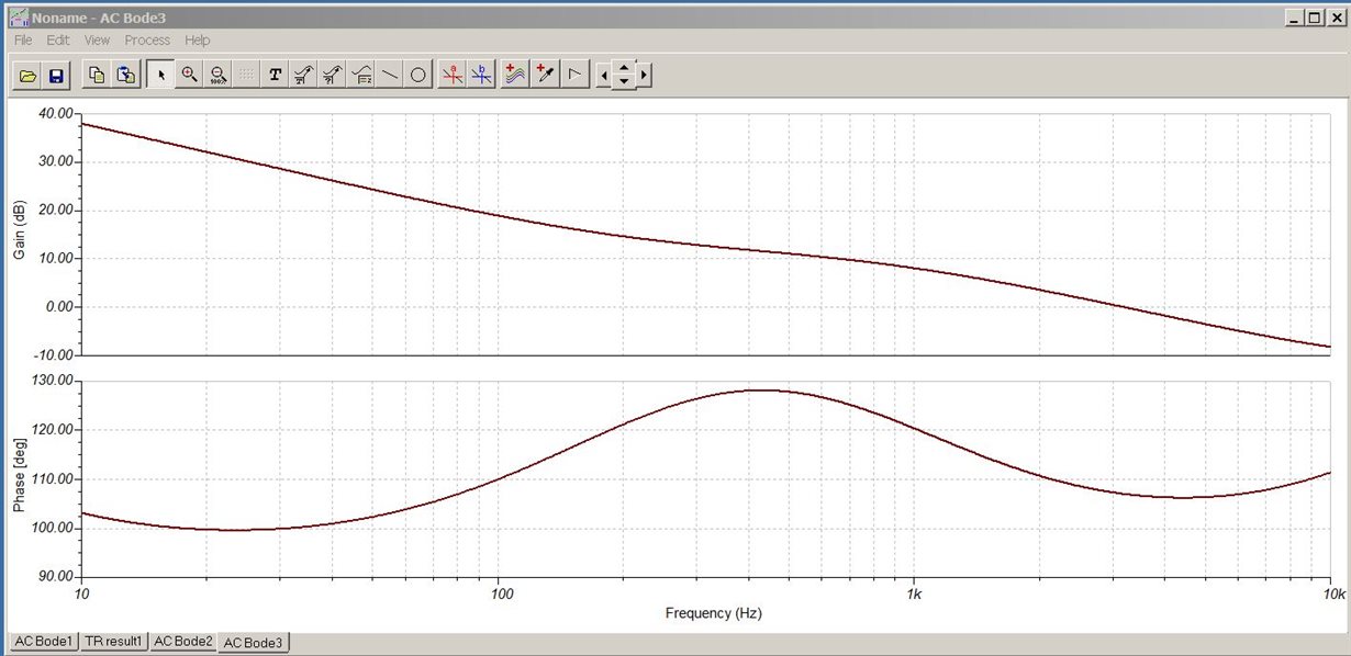

I'm trying to simulate the LM3478 TINA-TI Average SEPIC Reference Design from the product folder. How accurate is the model?
www.ti.com/.../snvmb83
Below is simulation from 10 to 10kHz as specified in the TINA file: the phase does not go to 0 degree - is this correct?

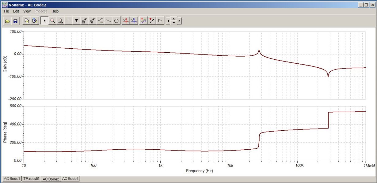

2nd simulation is to extend frequency to 1MHz (out of the range specified in TINA) as shown below: the phase is going so much higher! Correct?
