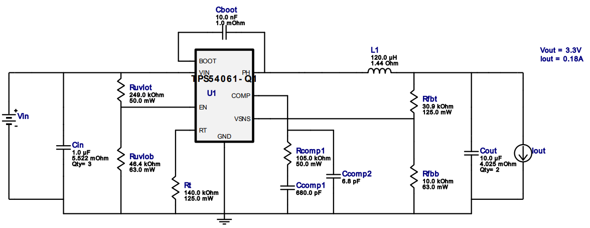

I noticed that the design report function does not output the correct schematic or BOM.
Actual design:

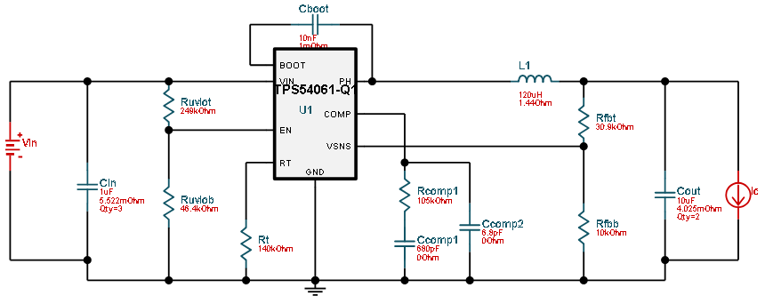

From report:

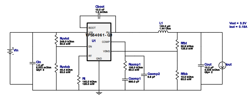

Actual design:

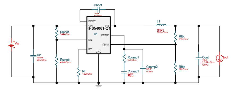

From report:
