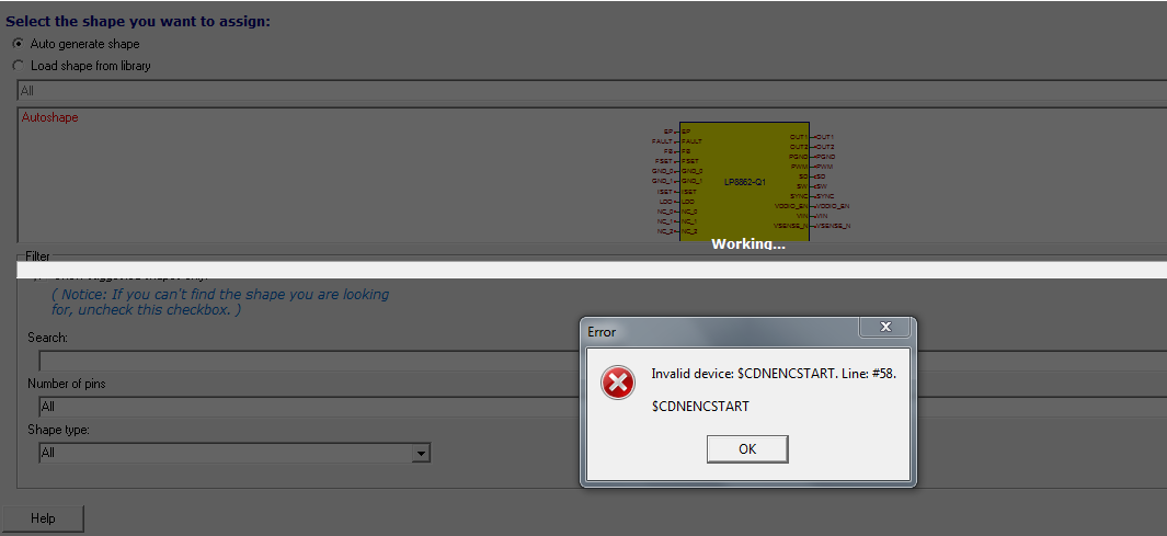

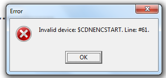

I found the LP882-Q1 Spice Models can't be used in Tina, the error as below when I import that into TINA,
Hi Xiaowei,
The Pspice model is encrypted and can not be imported into TINA-TI directly. Please refer to this FAQ for more details.
LP8862-Q1_PSpice Model_SNVMAV0.zipHello Nikhil,
follow the document guide, step 1 should to import the .cir type file. but I didn't found it in the LP8862-Q1 zip. as attachment I down load from TI web.
