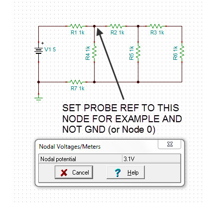

When using the 'probe' tool following a simulation, how does one chance the reference point?  It appears that the node designated as the GND is the only reference.  Is this correct.  If not how is this reference changed?  Seems like a fundamental thing that one would want to do.

  • Hi Herman -
    What I am trying to explain is that when an analysis has been completed (DC for example below) there are many times where I want to measure a differential signal between two nodes.  I would have thought that the virtual multimeter would work in this capacity.  Two probes would be used and a measurement could be taken between two nodes.  This does not seem to be the case.  I do realize that a VOLTMETER tool can be placed between two nodes but many times it would be nice to simply set the probe reference point (something other than GND) and make differential measurements.

  • I tried to paste an image of a circuit example and could not.  Therefore, I've attached a small image file of what I am attempting to describe.

  • Hi Jim,
    Unfortunately, this is not possible. Using Voltmeter is the best way to do this.
