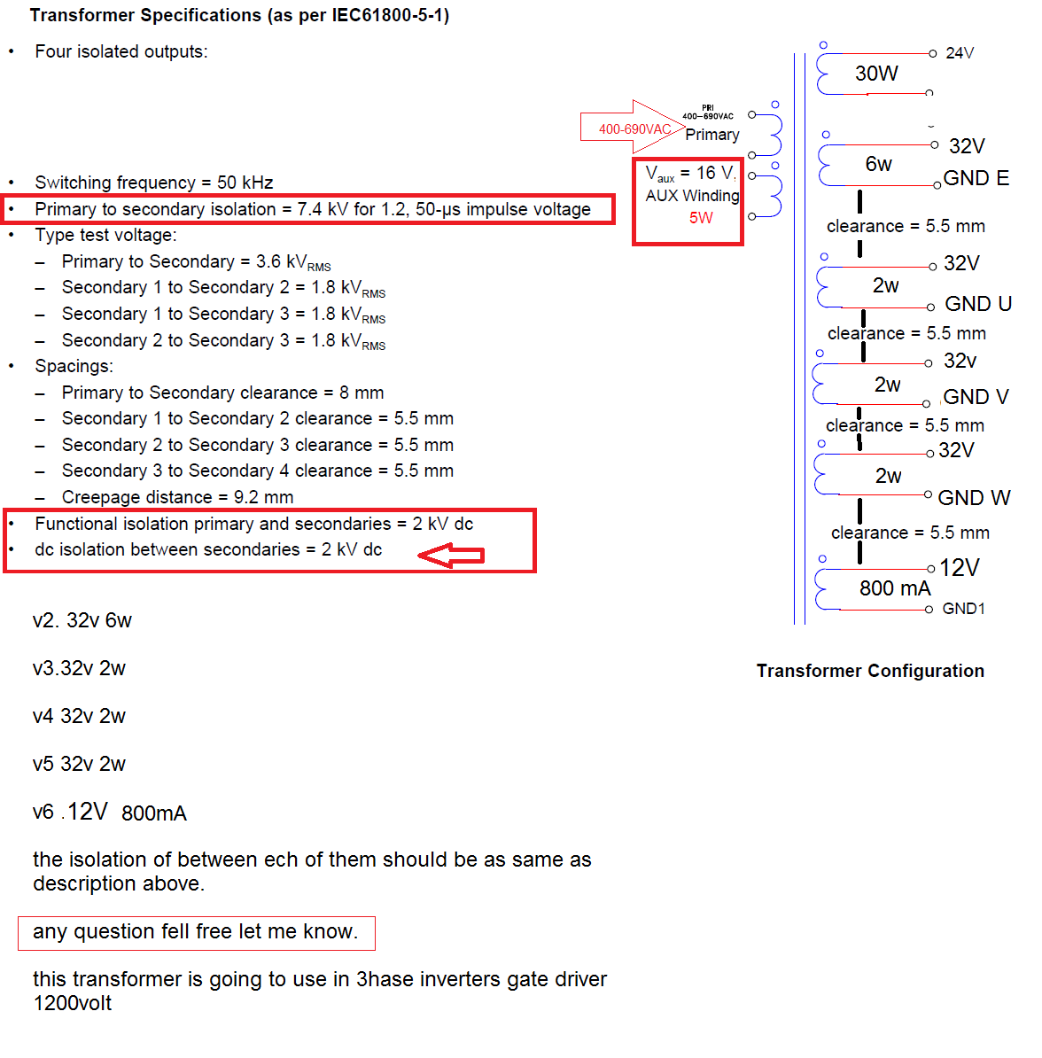

 I customized  the transformer of TIDA-00173 for my application to have :
    4 separate output for IGBT driver power
1.GND_U VCC_U
2.GND_V VCC_V
3.GND_W VCC_W
4.GND_E VCC_E
one output for fan
5.GND_24 VCC_24
one  output for  function board
6.GND_FNC VCC_FNC
one  out put for AUX ...
7.GND_AUX VCC_AUX
in put  voltage is 620VDC.
but sadly, It had very Spike in all of out puts.
so I came up with an idea to put capacitor (10nf 1000v) from HV+ coil pin to all of Ground pin in outputs (6 capacitor in total) .
in other word
C1(10nf 1000v) between  +HV ,GND_U
C2(10nf 1000v) between +HV ,GND_V
C3(10nf 1000v) between +HV ,GND_W
C4(10nf 1000v) between +HV ,GND_E
C5(10nf 1000v) between +HV ,GND_FNC
C6(10nf 1000v) between +HV ,GND_24
it works good ,and now my outputs have a small spike,
so,my question is that :
1. if is that wrong to put capacitor between primary coil and  all of secondary coils or not?
2.(as you know the IGBT driver powers must be separated from each other ),so those capacitor does have bad effect?
3.since it is customized transformer what else we can do to reduce the noise sound and spike of it.
thanks for attention .

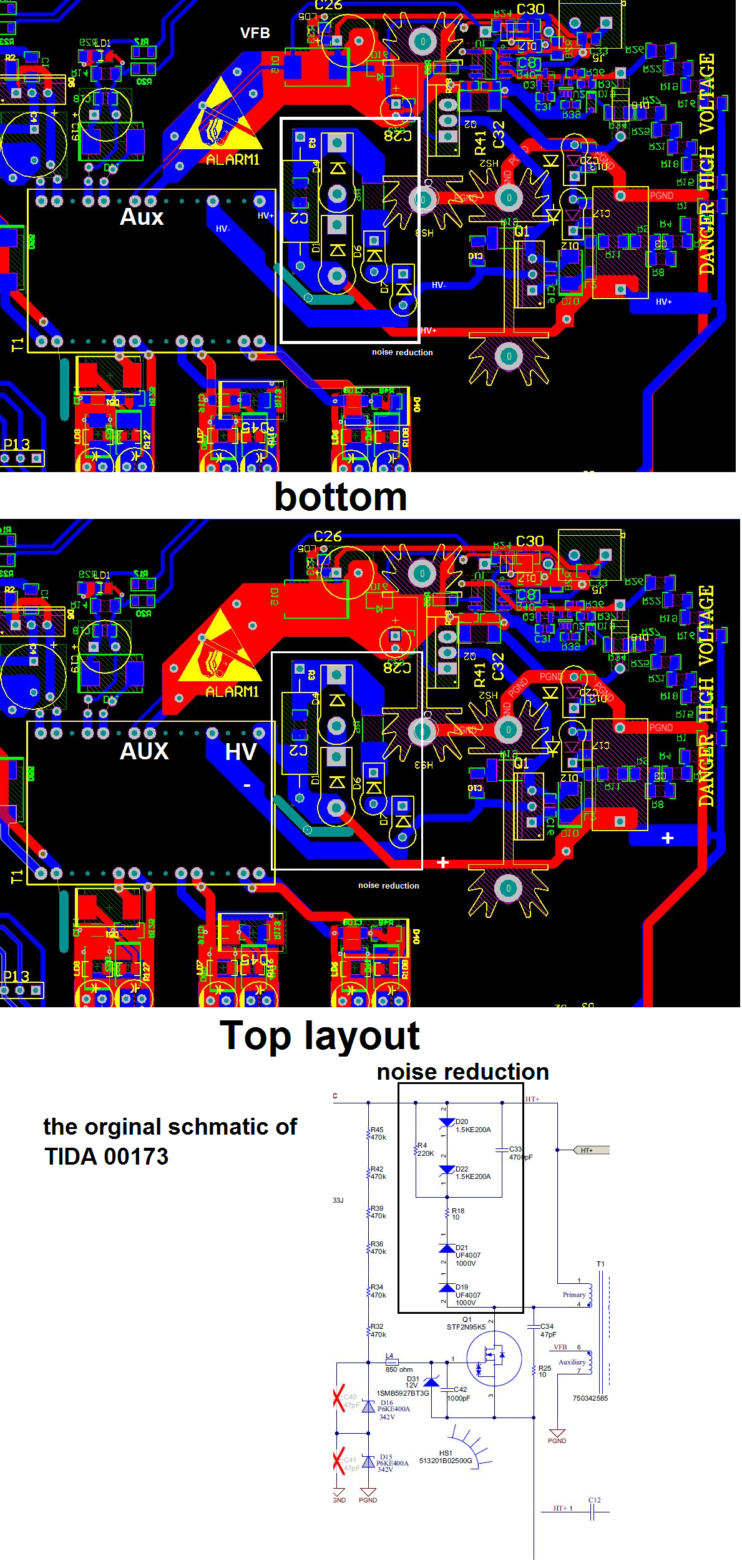

  • Thanks dear Siva I will send you my Altium Designer layout and also waveform of my power supply to help me more about that .
    because the switching transformer have very bad sound (noisy sound),I do not know if my PCB layout is my problem or the the switching transformer?...
    Dave
  • Hi Dave,
    Please share the layout files of PCB and transformer winding structure.
    Siva

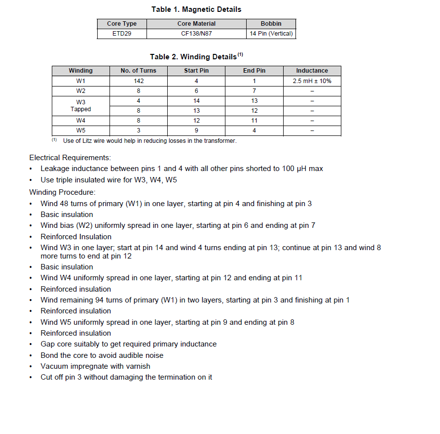

  • Thanks dear Sive for concerning about my problem here is my PCB layout but first of all I should mention that I lay out my PCB exactly as same as TIDA00173 the only change which I have made  is Noise reduction part which I signed in the pictures . but about the winding of transformer which you mentioned, I give it to factory to do that for me the winding turn in VH and Aux is according to instruction of    TIDA00173  datasheet but sadly they refuse to give me the structure of winding :(.
    perhaps the long track for Aux (VFB) or HV switching may cause a problem but in my board I did not have a choice to change the location of  transformer ..
    dear Siva may be that is the big request but ,would you please design a transformer.
    as you know the original form of transformer instruction is these two picture
    so what I want is sort of like this one which I show in below ...
    I don't know how to design it .
    Dave.
  • Dave,
    Thanks for sharing the layout information. The transformer PCB layout looks good except for the HV- track in the first image. HV- is the switching node and hence the source of maximum common mode noise. That track runs below the transformer winding region and increases coupling of common mode noise to secondary side. Please see if it possible t o re-route that track away from the winding region. Also, adding a shield layer(grounded) between primary and secondary winding helps in reducing the common mode noise on secondary side.
    Hope this helps.
    Siva
