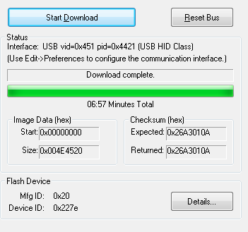

I can using composer to update FW on programming mode.
The picture is show the debug message by RS_232_M including boot normally and abnormally.
Please help me how can I debug next step?
