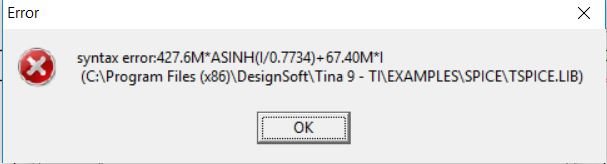

I am trying to import a spice file of an SiC N-Channel Mosfet from RoHM SCT2160KE. The spice file is available on their website and as I am importing the file as a new macro file it is showing me an error. Please help in resolving. this issue

    It is difficult to interpret just by seeing the error. The error may be because of spice netlist syntax or related to the import process. Please review the process you are following to import the spice file or else please try to refer the attached link for the procedure to import the spice file.
    www.ti.com/.../slva527.pdf
    If the same problem persists then please send me the pspice file which you are trying to import, we will help to resolve the issue.

    This question was answered just a few days back and several times in the last few years. You can find the solution here:
    It would be great if you can do a search on this forum as many commonly asked questions have already been addressed. We will be happy to help if you are unable to locate the answers.
