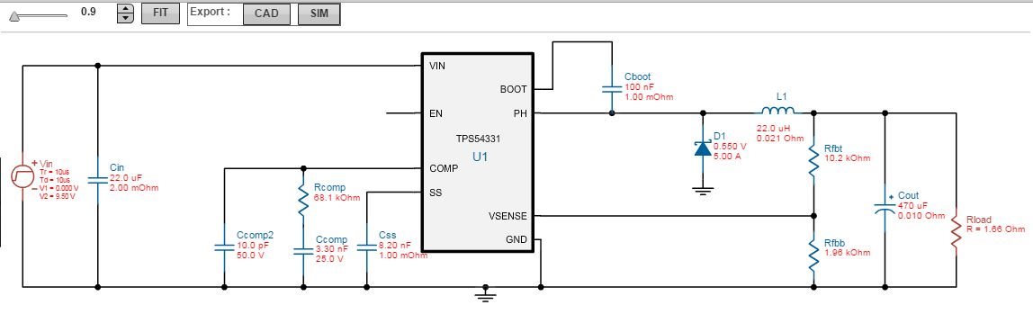

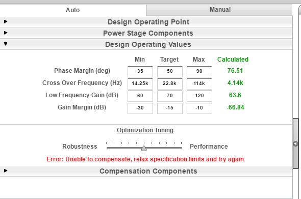

When using TPS54331DR Buck IC as bellow sch.12V to 5V 3A Load.The WEBNCH Tools can not calculate the right compensation .And can not calculate the right compensation components.

Thanks for sharing! Since Cout is higher, you'd need a larger Rcomp to get a higher crossover frequency. If you increase the Rcomp max limit from 100k to something like 400k, you should be able to auto compensate.
Here is an example compensation in this shared design: https://webench.ti.com/appinfo/webench/scripts/SDP.cgi?ID=020668EE7AFDB4B3
