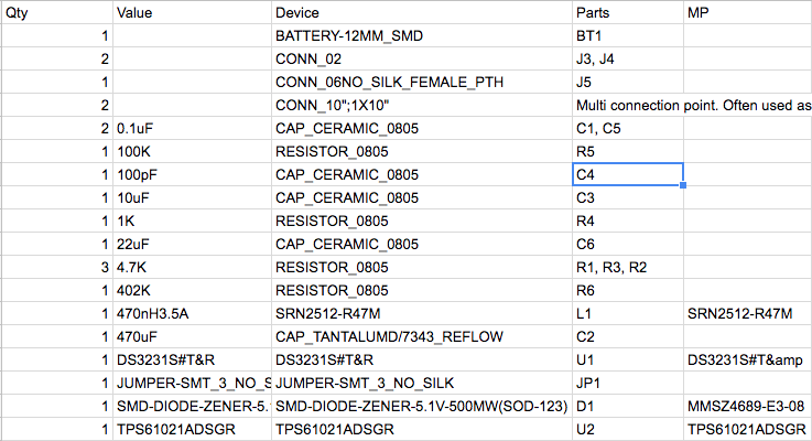

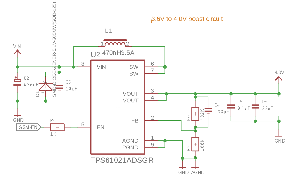

Can I use this zener diode: MMSZ4689T1 instead of the original one - 1SMB5918BT3G used in the design?
Also Ive created a gsm supply using reference design. Could you please review the layout and suggest improvements
if any?
Schematic:
BOM:

    By Io and Io max, I hope you are referring to the load current, right?
    Usually its in the 20mA to 100mA range with the pulse current that be as high as 2 A and last as long as 577 µs within a 4.615-ms period.
    Since it powers a SIMCOM800C gprs module the avg current comes out to be 250mA.
    Also, there is a solder pad below the IC. Are you saying that I need to bury a via
    below that? Wouldn't it be enough if I include more vias very close to the
    IC at the output side or will below the IC be a must?
    Also, I had read in a TI application note for power supplies that the
    Analog ground and Digital ground must be connected at only one point.
    Since the lower ground is feeding the rest of the pcb also which is mostly
    serving digital signals, I've added vias
    only at the output side, to ensure a single connection point between the two.
    Rgds
    Karan

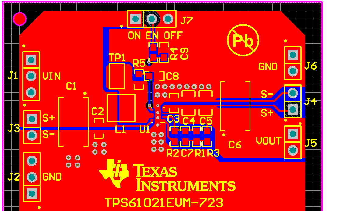

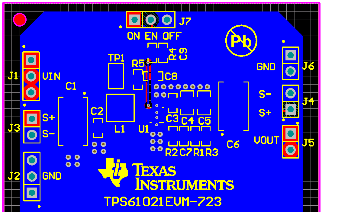

    For the layout, please refer to the section 10.2 in the datasheet on page 18. or please refer to the TPS61021 user guide.
  • Hi Sir,
    Yes, what I mean is the load current.
    Yes, bury vias. Please check the TPS61021A EVM layout in the below picture.
    top layer:
    Bottom layer:
